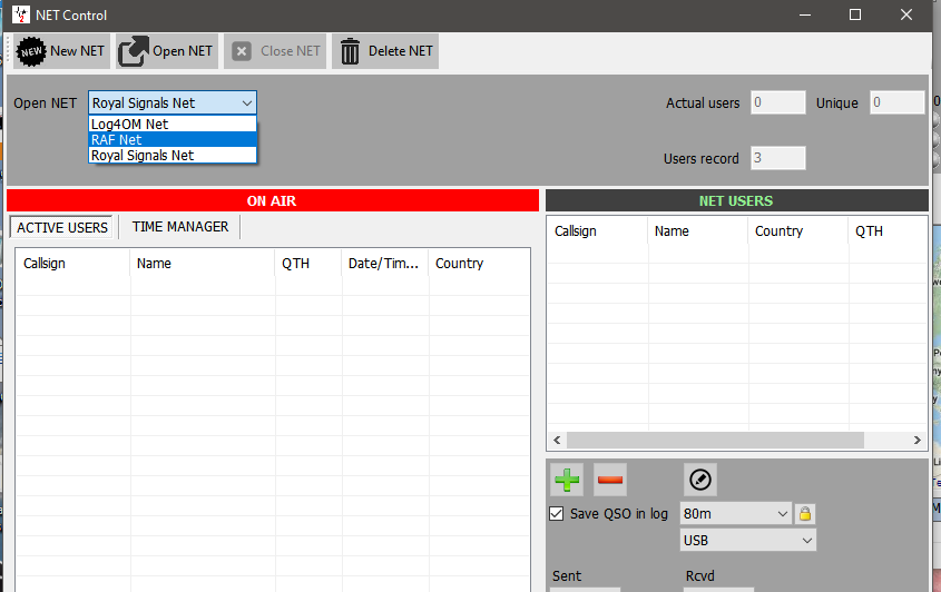

Hi everyone
New to v2, great software, however - having just set-up v 2.4 I get notification that 2.5 is released and yesss Net Control is included, so having set up and got the program roughly how I want it I decided to create our Club Net which includes about 12 or so stations - all went well and seems fine.
Then I decided to create a listing for a Joint local club net which often tops 20 stations, having made the entries I then closed the net as normal - then went to re-open to find it did'nt exist, it disappeared !
Three times I have performed this routine and the nets have not been saved - furthermore I created a "Test Net" which DID save, but then discovered I could'nt delete it either... so at the moment somewhat disappointed with that feature - which worked well on v1.
I ask the question as nothing has yet been posted on this topic since it has only just been introduced in v 2.5 .
Dont think I've missed anything, but thought it could be an issue that (Might) need attention.
Rgds Peter G4NKX

Thank you for your reply - I do have the Log4OM2 manual here dated 30/3/2020 and does not mention Net Control, since it's only just been released - Anyway regarding the problem :- I created different net and inserted a few ficticious calls in the list - then closed it. I then tried to delete that net using the delete button, a pop-up box appears telling me that it will remove all participating stations, and thats exactly what it does - however the net is NOT deleted - I now have a couple of nets that wont delete.
I went to the trouble of re-installing Log4OM but it's the same (I'm running W10 Pro) Log4OM v1 runs Net Control without hitch.
It would be interesting to see if this problem occurs elsewhere ?!
My one and only net IS working for me so far so dare'nt touch it at the moment :) so not sure where to go at the moment - I still have v1 on board so could use it just for nets then export to v2 (Not ideal) . .
rgds Peter G4NKX
