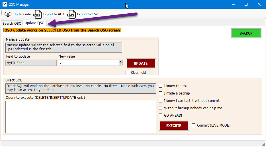

I would use the QSO manager to do that. Make a backup of your log by exporting an ADIF.
Under QSO manager click the update QSO tab
Select MyITUZone and set the value to what you want and update.
Once again make a backup first.
Rich
Rich

Did you happen to have a date range set in the adjacent tab called "Search QSO" ?? You might have accidently had a from/to date range set.
