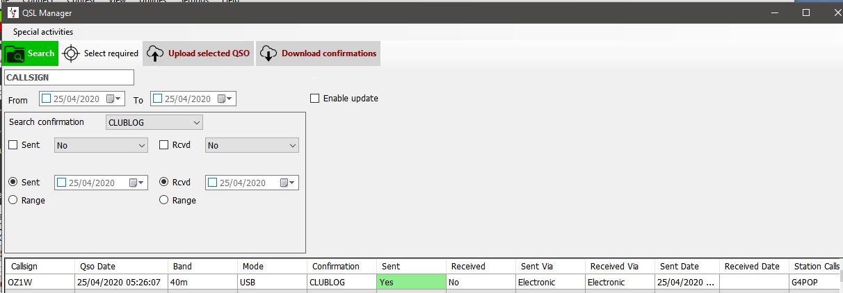

You dont say which release of Log4OM you are using so that does not help me guess your problem!
I have just automatically uploaded a QSO to Clublog and as you can see from the graphic below its working fine.
Did you realise there is a delay in upload of 2 minutes to allow for deletion of QSO's so if your expecting instantaneous changing of the upload flag it wont happen.

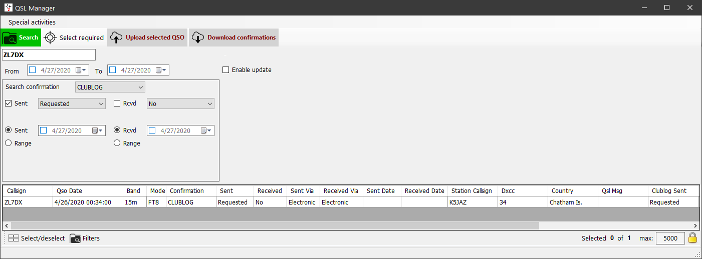

I thought my first post was quite clear, sans the version. For that I apologise. I'm using Version 2.5.0.0. I am aware of the posting delay.
Upon logging a new entry, the QSO is properly posted to ClubLog, but the "Requested" flag in Clublog Sent column does not change to "Yes" as expected. This same configuration is working properly for eQsl and QRZ.com.

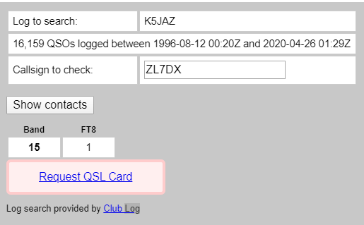

Below is a contact I made at 00:34. I checked clublog at 00:40 and this contact had in fact been uploaded. The concern I have is that Clublog confirmation is still reading "Requested".

If I manually upload an entry to Clublog, it updates "Requested" to "Yes" in Clublog Sent column as expected. When automatically uploaded, this update does not occur.

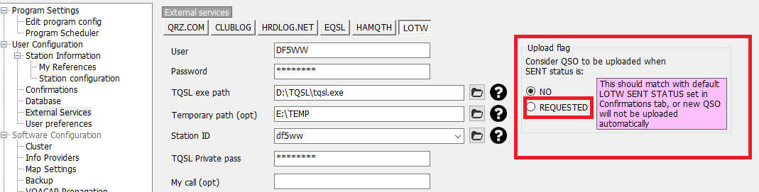

Re: Clublog confirmation not changing from "Reguested" to "Yes"
Set Clublog send status to NO instead of requested and all automatted uploads will be work fine.
If you have it set to requested Log4OM will not send it automaticly. The only one service where
you can change a upload flag is LotW.
