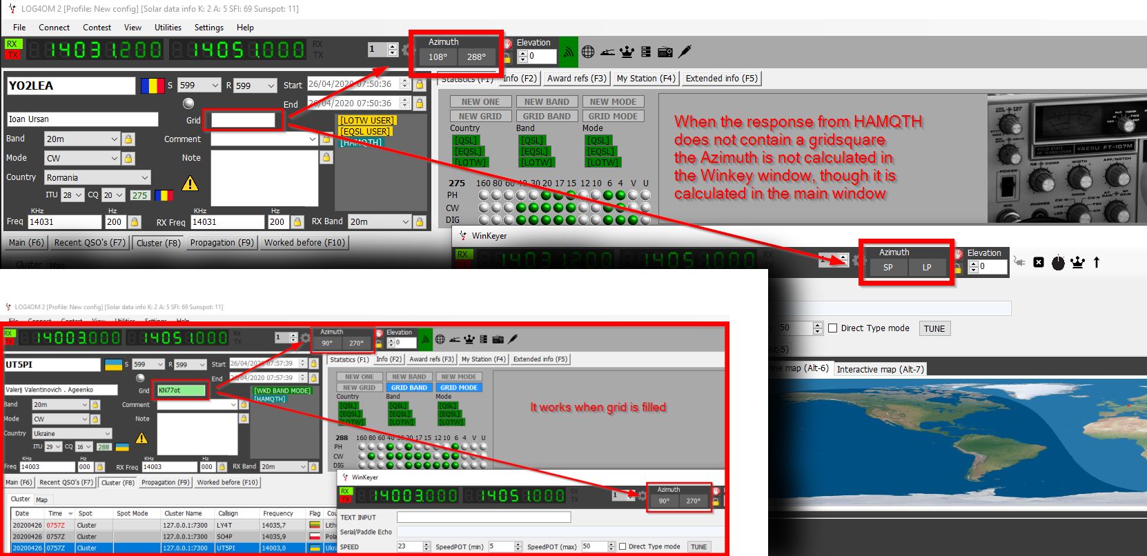

Azimuth not calculated in Winkey when Grid missing from infoprovidor
Post by PE5TT »

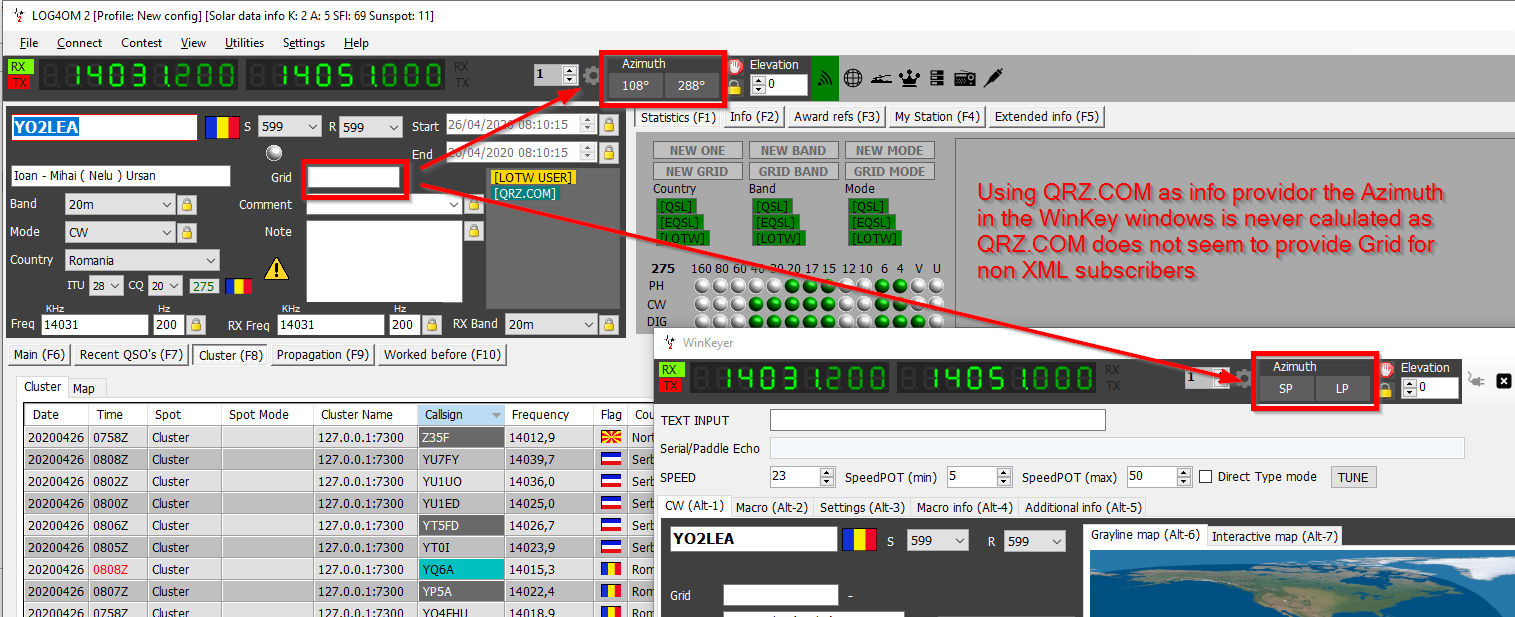

I found the the azimuth is not calculated in the WinKey window when there is no Grid in the response from the info-provider. In the main-window however the Azimuth is calculated
When i use QRZ.com as info-providor the Azimuth in the WinKey window always fail as QRZ never seems to provide Grid to non XML subscribers. But again the main-window does display Azimuth

Now that i see this i think this might be part of another issue where distances are no longer calculated in my "Recent QSO's" tab.
Only the QSO's that have an valid Grid response from HamQTH seem to get distance calculated.
Log4OM used to fallback to the middle of the country distance and azimuth when no grid was provided, but that is no longer happening.
The calculations are still made, as in the DXcluster windows both Distance and Azimuth are visible for every entry.
