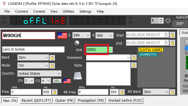

Tried different US callsigns and all show the correct one if they stored it at the different
lookup services. Am using here HamQTH for my lookups. If you use qrz.com and you get
the wrong locators it must be a problem at their side. Nothing changed in Log4OM that
can cause this.

I have upgraded to the latest version of LOG4OM today. The problem with All US stations showing up as grid location EM 19 still exists. I only see it on the LOG4OM front page, that problem does not exist when looking at the VE7CC cluster in the cluster management screen of LOG4OM 2. There must be something that differentiates the grid locator between the cluster management screen and the LOG4OM front page when viewing the cluster. It's not QRZ.com and it's not the VE7CC cluster. Those are the only two references i use. Of course when i look up my call sigh it returns the correct grid, DM52ba but if it is a call sign coming off the cluster data, it is wrong for USA stations. Only EM19 reported.DF5WW wrote: 03 May 2020, 09:06 Tried different US callsigns and all show the correct one if they stored it at the different
can cause this.
Larry W0OGH

The cluster only checks country and CTY files to obtain a mid country locator but when the spot is clicked to transfer to the lookup screen an in depth check is done for the correct locator, you will see locator and azimuth info change as it's looked up
We can't rely on the incoming raw data from the cluster because not every server is as good as ve7cc and the cluster would slow to a stop if we did a full in depth lookup for every spot.
