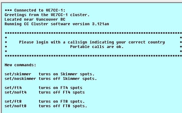

Not sure which cluster you are using as there are many to choose from. I tend to use the ve7cc cluster most of the time. I'm also about 99% CW and use the 'set' commands that Lee Sawkins has available for his cluster. Screen clip below shows those command from the logon tab of CC User. I also set certain frequencies to pass or not pass from the CC User. Once I get things tweaked I close CC User and my ve7cc cluster view in V2 is mostly free of digital spots.
The ID's for the digital modes tend to show up in many locations so it is difficult to have just one switch to toggle their view on or off.
