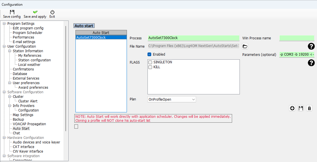

I searched and founf this thread to set the 7300 clock on startup of L4OM. Praise the LORD!!!
I tested it under the Command Prompt (W11) as ADMIN and it worked. This was the config: Set-7300Clock.exe -p COM3 -b 19200 -i -u
I added it to C:\Program Files (x86)\Log4OM NextGen\AutoStarts\ and went to Program Config> Software Config>AutoStart with the pramaters I wanted, enabled it and saved it. See screen shot below
It did not start although the log file shows it ran, here is the clip of the file
2024-09-09 23:40:23.9128 INFO: [dje_zJTRBJVFT64FYCFF9HV65UAFYPM88QHYSX3_ejd] : [UPDATE] Starting refresh of METAR data...
2024-09-09 23:40:24.0691 INFO: [dje_zGUN65TW2KQJHNCG5FGGKDPAL2FBA_ejd] : KLRO 092335Z AUTO 00000KT 9SM CLR 23/20 A3008 RMK AO2
2024-09-09 23:40:24.0847 INFO: [dje_zJTRBJVFT64FYCFF9HV65UAFYPM88QHYSX3_ejd] : [UPDATE] Refreshing METAR data updated successfully
2024-09-09 23:40:24.0847 INFO: * [dje_zJTRBJVFT64FYCFF9HV65UAFYPM88QHYSX3_ejd][171 ms] : [UPDATE] [END] Refreshing METAR data process completed
2024-09-09 23:40:24.1159 INFO: [dje_zZ6TU7566LE9B42TQ68LLZ_ejd] : Executing C:\Program Files (x86)\Log4OM NextGen\AutoStarts\Set-7300Clock.exe -p COM3 -b 19200 -i -u

Any suggestions?

Any suggestions?

Re: Set Icom 7300 clock from LOG4OM?
Probably the port was already in use by CAT control like Omnirig or Hamlib
The autostart is designed to start other software not send commands via a com port which might be in use already
