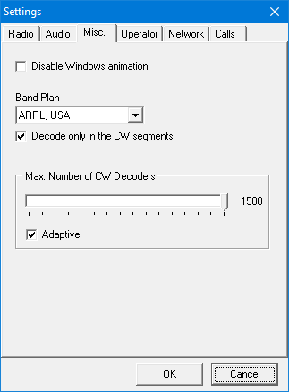

Couple things you might try.
In skimmer tell it to only decode the CW portion of band and possibly mess with the Max # of CW decoders.
No idea if that will help you or not, but worth a try
Rich
Rich

Cheers Rich
I already have the decodes set to the minimum which is 50. I've just set it to decode only cw but it seems to be doing the same. What seems to be happening is every time I click on a spot in log4om cluster to move me to the spots frequency it seems to go up a couple of percent. after 50 clicks on a spot its starting to redline and crashes. I upped the priority in windows to high but its not made any difference. Task manager tells me I'm only using about 50% cpu and 40% ram. I've just noticed if I move frequency manually using the radio dial it goes up from say 25% to around 35% but then it drops back down to 25% but clicking on a spot in log4om cluster increases the % but it never drops back down. I guess not clicking on spots is a work around but tbh its annoying

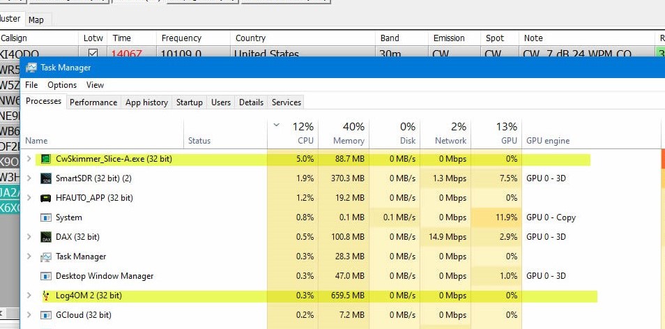

For what it is worth. Here is my system resources usage.
Skimmer is by far the most intensive. I am aggregating my skimmer and also spots from a telnet server online. My skimmer is set at 192K of bandwidth.
As you can see Log4OM is idling along.
Hoping the next version of CWS is improved.
