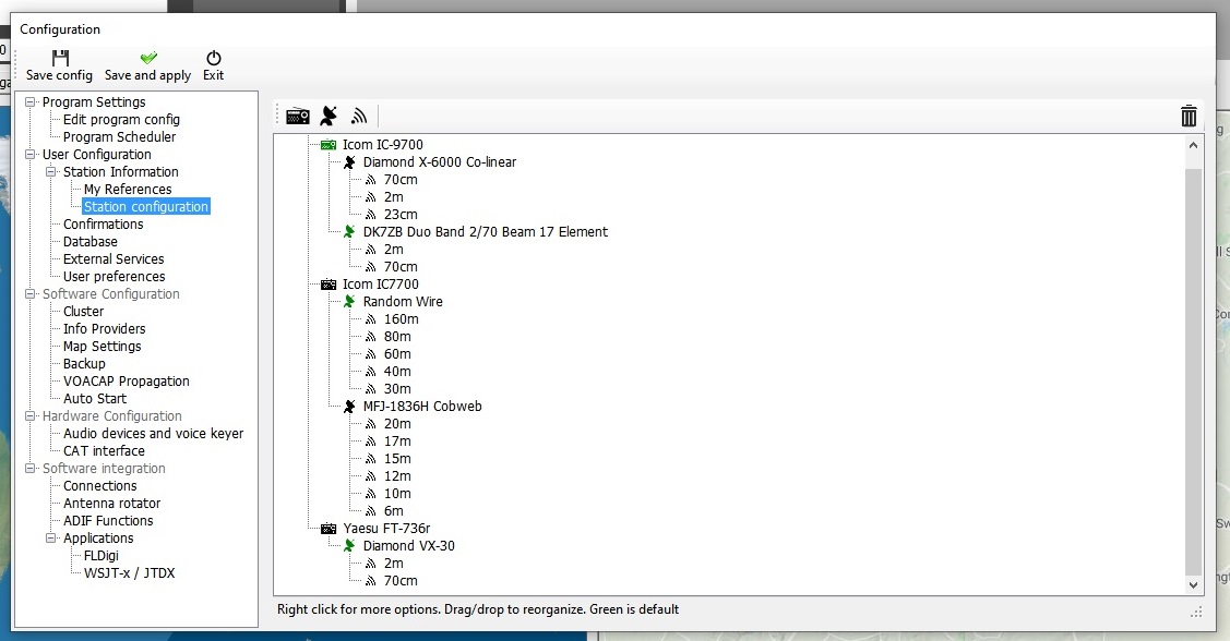

Thanks for looking into this for me, I run 2 instants of each Jtalert and WSJT-X, one for my IC-9700 and one For IC-7700 so i can run ft-8 on both at the same time, logging works great (expect for radio/antenna used), all using omnirig, the logbook is connected to both radios (rig1 and rig2) no problems. I would of thought with the band being logged it might log the correct (default) radio/antenna for the band set in station Information automatically.
update... I've just tryed logging on 20m band and 80m band on same radio, the antenna logged as cobweb not two different antennas, so this appears not to work. my conclusion is I've got something wrong. I have including Picture Below of Station Information settings.

After another play and re-reading the user guide, I now have the antenna logging correctly for the band i'm using. It was my mistake as you probably seen from the above screen shot, I had not selected the default antennas correctly.
Just a Shame it doesn't log the correct radio for the band, as I switch between both HF and VHF, but for now i'll have to remember to switch the radio manually before it logs.

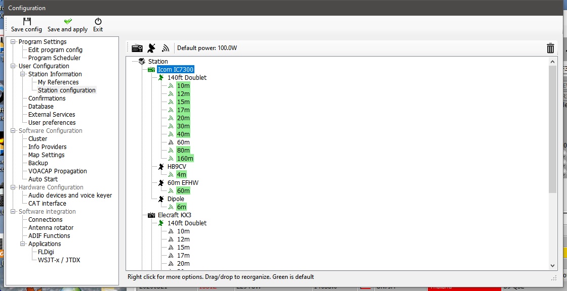

Re: Station Information
Daren,
You dont have any default bands set for your aerials You need to right click on the relevant bands and set as default, the band will then be highlighted in green as shown in our user guide and the image below
In my setup for my default radio the IC7300 it automatically selects.................
The doublet for 10, 12, 15, 17, 20, 30, 40, 80 and 160M
My HB9CV for 4m
A 60m EFHW for 60m
And finally a dipole for 6m
But note I can also use the doublet on 60m but it has to be selected manually because its not set as default
My HB9CV for 4m
A 60m EFHW for 60m
