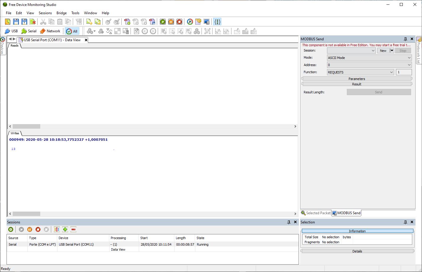

Update, this morning I tried to snif the COM between Log4OM and winkeyer, these are the results:
2.5.0
2.6.1
From 2.5.0 it is possible to see the cmd Host Open [00-02] and Load Defaults [0F-46-...] while in 2.6.1 it is almost blank (only first 0x13 byte sent (btw, is it Load EEprom cmd request?).
73 IK3LLS
Re: Winkeyer issue in 2.6.1.0
Hi, the only thing that changed is a DTREnable command sent during initialization phase to raise DTR pin and support serial winkeyers giving them the power they expect through the DTR pin.
That should not change anything i suppose...
