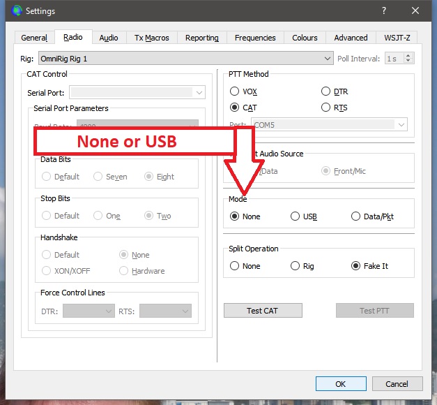

I got the radio to connect for both LogOM2 and WSJT. I now have a new problem:
When the WSJT software goes to TX, the radio switches to RTTY R. I can't find the setting that keeps it in USB D.

I don't quite follow what you mean. The frequency is displayed correctly in WSJT. I don't think there is a setting in WSJT that would allow RTTY operation so it cant be WSJT. I tried with HRD and it doesn't switch the radio to RTTY R. I wonder if I set something trying to get this to work
Re: When using WSJT, Radio Switches to RTTY R
Did you change any CAT settings in the Log4om program configuration menu?
Your WSJT settings should be like these settings which I use with my Icom IC7300

That was the reason. Now those are working great. I now know how that got changed. I was trying to do something else. Thanks for your help.
