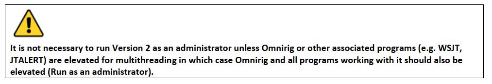

Re: CAT Issues
G4DWV - Guy wrote: 04 Jun 2020, 22:31
I have the latest manual of Log4OM, but did not get any hits for 'admin' or 'privileges' when I searched using those terms.
Page 12

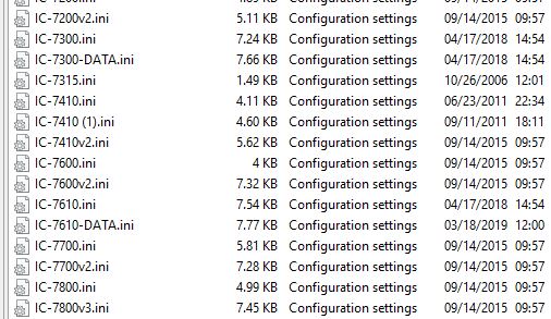

Re: CAT Issues
OM - and others saying they can't find "their" rig in the OmniRig Rig list ...GW4XCA wrote: 06 Jun 2020, 16:40I was about to ask the exact same question.G4DWV - Guy wrote: 04 Jun 2020, 22:31 I wonder if you could answer a question about Hamlib in Log4OM for me. FLDigi has a version of Hamlib that lists the IC-7300 as well as that module being stable. The version in Log4OM does not even list the IC-7300. How can I get the same stable module in Log4OM?
I use Hamlib for my other programs and everything works well with my IC-7300 so I would like to stay with that, but as you say, the 7300 is not in the list of available radios.
I can't get Omnirig to play ball.
Have you taken the time to maybe download the most current rig list from OmniRig? Do that and unzip the file and place it where it should be located on your HDD and then restart OmniRig and take a look-see.
I'm guessing you might just find your rig.
Below is a screen clip of the actual rig list that is on my laptop's installation for OmniRig. It has the most current list.
If you note on the image you will find the Icom rigs that y'all have saying you can't find.
- OmniRig-rigs.JPG (57.88 KiB) Viewed 4530 times
