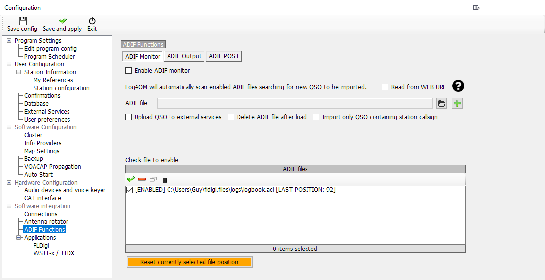

I have disabled ADIF monitor (see screenshot), but still get duplicate QSOs.
They are not identical as one entry has the ops name and the other does not.
The times of the QSOs are not identical either.
Please advise if there is something else I can try.

Hello Guy,
looks like you have setted up WSJT-X/JTDX AND JTalert to log to V2. Disable ADIF_Message from WSJT-X/JTDX in the
comunication settings in V2 and JTalert log the qso. It´s described in the manual starting at page 162 in the actual manual.

Try unchecking the enabled box alsoG4DWV - Guy wrote: 06 Jun 2020, 00:54 I have disabled ADIF monitor (see screenshot), but still get duplicate QSOs.
They are different because one is just a copy of the WSJT ADIF and the other received in the correct way has been checked and updated on import

Neither of those options worked, I'm afraid.
Cheers
UPDATE:- Now, with both ADIF monitor enabled and the fldigi log enabled, I am getting one entry per QSO! I am getting an entry without the op's name, but would prefer the one with the name.
