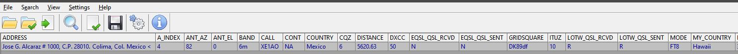

I recently set up Log4OM V2. I uploaded contacts to LOTW yesterday and there was no problem. Today, LOTW would not accept the upload because the country on my TQSL certificate (Hawaii) does not match the information Log4OM is uploading (United States). If I open the station program config in Log4OM, it shows my country as Hawaii. However, if I open a specific contact in the log to modify it, my QTH tab lists the United States. In order to upload, I have to physically modify every single contact, one by one. Just to be clear, the contacts I uploaded without problem yesterday all list the United States. It seems LOTW was not as pickly yesterday.

Thank you for your reply. I am using version 2.7.0.0. My contacts are from JTDX to JTAlert to Log4OM. However, I maually added a contact, and the results are the same. The program configuration says Hawaii, and has the correct grid, ITU zone, etc, yet the log contact says United States and must be manually modified each time. I am sure I have saved it properly, as the program has been closed and reopened, and the computer rebooted as well. After restarting I have checked the program config and it is correct. I think my next step will be to uninstall and start over.
