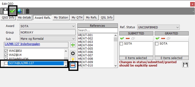

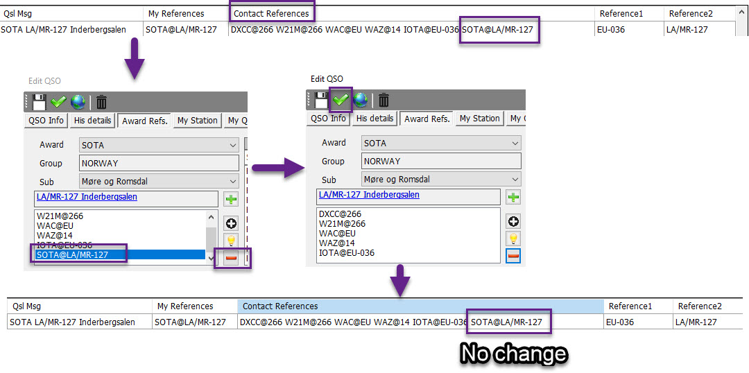

I accidantly added my SOTA reference to the "Award refs.", that containts the award references from the person I talked to. Now it lookes like we were at the same mountain, having a S2S.
So, I do the following to (try to) solve the issue:
1) Right click on QSO, "Edit QSO"
2) Go to "Award Refs."
3) Mark the error SOTA reference, and hit the delete button
4) Save and Exit.
Result: No change, as I return to the QSO the same SOTA reference is still there.
Any ideas on what I do wrong, or is this a bug in software? I have same problem with all QSO's (5 in total) I've tried to fix.

LB4MI is right, references of the other station (inconsistently called award ref or contact ref) cannot be removed. The check mark goes away, but when the view (recent QSOs or QSO manager) refreshes the entry is still there. Using version 2.7.0.0.

2) I have now run the "WIPE AWARD REFERENCES" and after: "RESCAN AWARD REFERENCES", did a restart of Log4OM, and it did not change the issue.
Using filters, it lookes like I have 11 of these QSO's where the SOTA reference is on the "Contact references", i addition to be on "My references" (not all refs. are in place on "My ref." perhaps after the wipe, but I'll easilly clean that up later)
Where the "Contact references" can't be removed, or; it re-appears when I exit the "Edit QSO".
