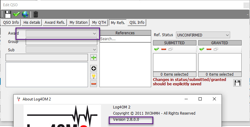

For some QSO's, it's not possible to add an award later on.

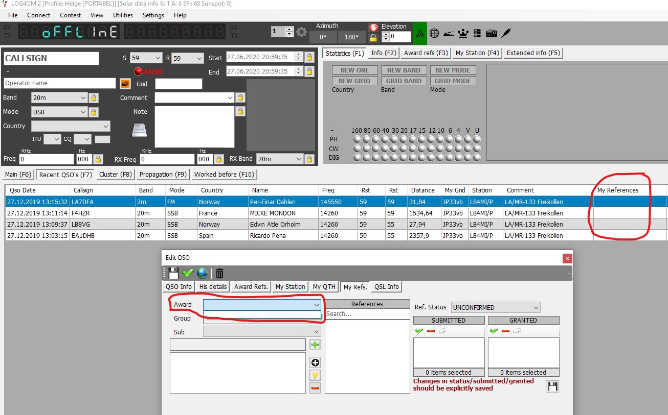

E.g. in the picture underneath, I want to add the SOTA reference to the filtered QSO's. As shown, the "My references" are empty, and I right-click and "Edit QSO", and open "My refs."
When I try to open the drop-down list of "Award", it's empty (as shown).
Any ideas? The QSO's are made with V1 of Log4OM, as they are from before V2. But I'm not sure if this is the reason... I don't see any logic pattern...

Hi, no change in 2.8.0.0, still not possible to add award. The "Award" is blank when I open it.

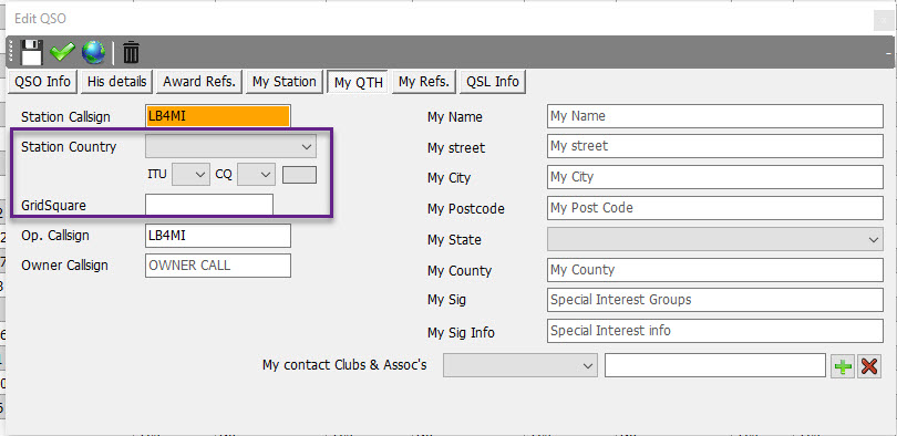

Hi any future reader,
the cause of the above issue was that the "My QTH" did not have Country and GridSquare filled in.
Once this data was entered, I could add "My Refs." with no problem.
