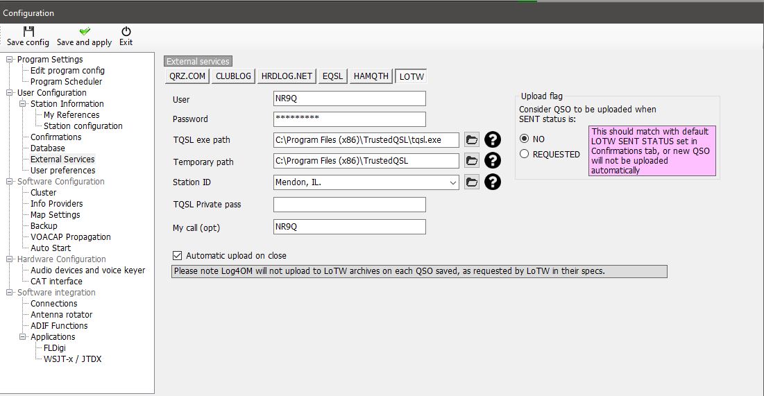

Log won't upload to LoTW upon closing Log4OM 2. All other services are uploading QSO's upon logging. I have selected upload flag REQUESTED and NO. NO is what matches the log LoTW sent status in my log. When this is selected the exit slash screen freezes and does not close out all the way. If I leave upload flag at requested, everything closes just fine. The log does not upload though. I have TQSL updated and had restarted the computer after the recent updates. I will try to post a picture of my configuration screen with this message. Not sure where to go with it at this point. 73

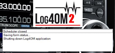

Here is what it looks like when the closing slash screen freezes on close. This only happens when upload flag box is checked in the Program Configuration > External Services > LOTW > upload flag is checked NO.

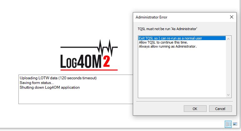

I have they same issue and have followed the advice in the earlier posts but so far the issue remains. When I do a manual upload using TSQL it does warn me that there are QSO's that have been uploaded, but once I say "Ignore" it proceeds OK. Could it be that Lg4OM2 is getting the same message and getting stuck? I also get the error message that TSQL cannot be run as administrator (when LOG4OM2 is doing the upload). I am having to run LOg4OM2 as administrator as I am also using Omnirig. TQSL is not set to run as administrator

The only time you need to run certain APPs with Admin Priviledges is when you are using OmniRig and needing its use of what is called "multi-threading". That is where multiple APPs also use the OmniRig CAT function at the same time.
That being said if you are using WSJTx or JTDX for digital operating and have Log4OM V2 running for logging and also use OmniRig for the CAT connection then OmniRig, Log4OM V2 and whichever of the digital APPs you use will need to be run with Admin Priviledges.
If you happen to use JTAlert between WSJTx or JTDX and Log4OM V2 it does "not" need to run with Admin Priviledges.
Using the LOTW TQSL has nothing to do with OmniRig CAT services and does not need to be run with Admin Priviledges.

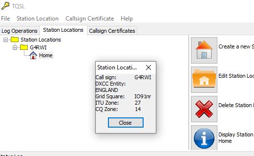

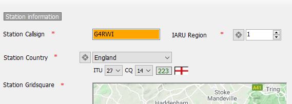

3.Country, CQ and Zone settings
country settings LG4M.JPG (22.3 KiB) Viewed 5495 times
country settings TSQL.JPG (31.83 KiB) Viewed 5495 times

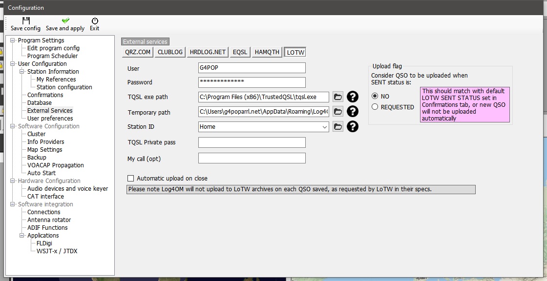

If I select the first option, LOG4OM2 quits nicely but nothing is uploaded to LOTW
The other two options LOG4OM2 hangs for ever, and nothing is uploaded to LOTW

Hi ????
This is where you need your LOTW settings!
Nigel
