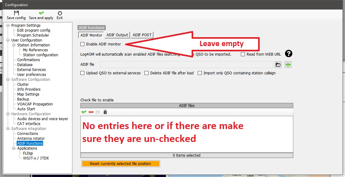

Re: double QSO in Log4OM running WSJT-X and JTALERT
Please read the latest user guide re set up
You should disable ADIF monitoring for WSJT and just use the setup described in the latest user guide, you are saving from JTAlert to Log4OM and simultaneously reading the WSJT ADIF file for new QSO's!
There is a warning about this in the latest user guide, please download a current copy

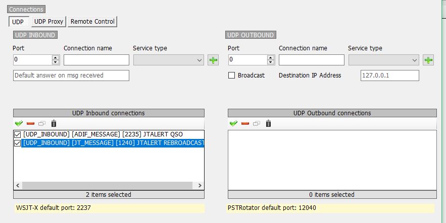

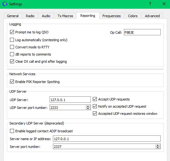

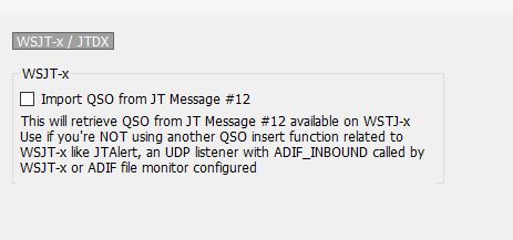

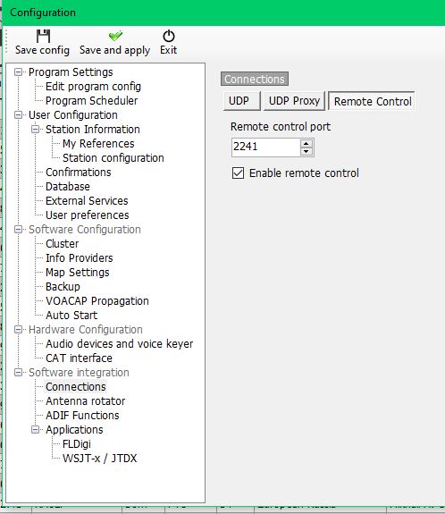

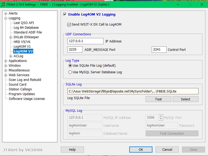

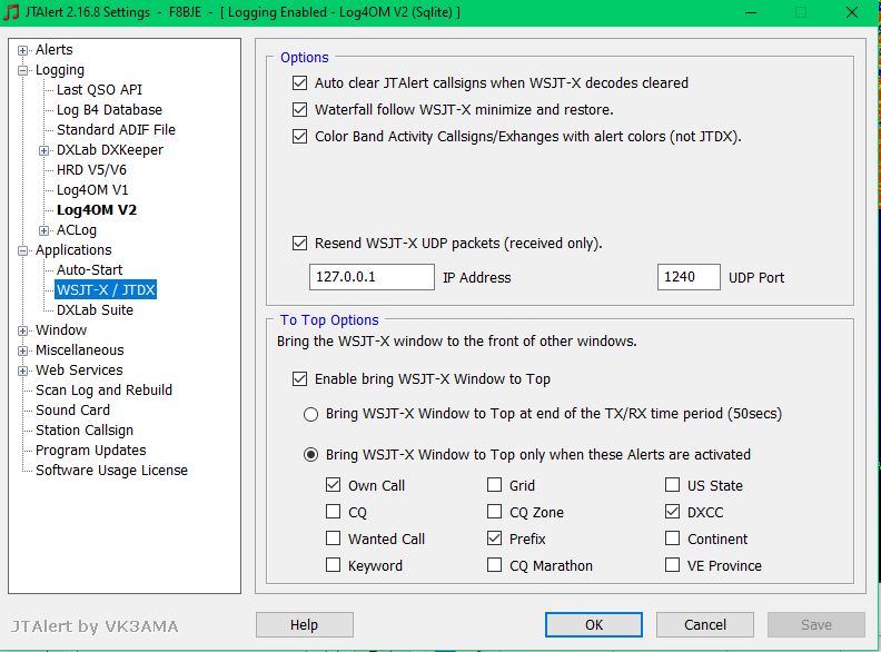

Reading user guide updated : 27/06/2020 11:09AM.
Here are my settings, what's wrong ?
f8bje
Posts: 13
Joined: 23 Jun 2020, 08:36
Post by f8bje »
setteings (suite)

Now it' works fine !
Many thanks dear Terry for your precious help.
