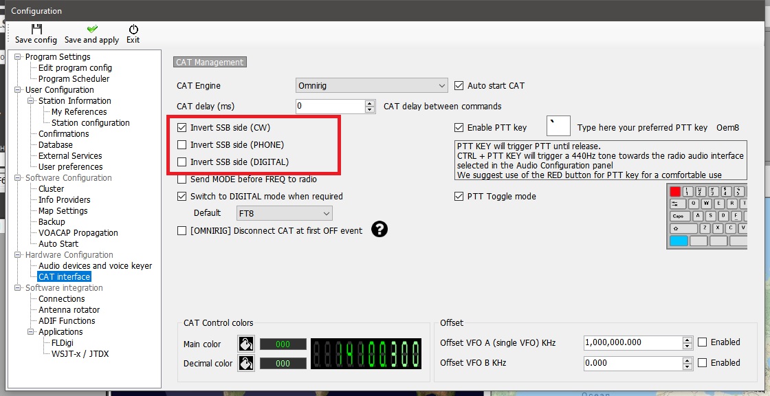

I just cannot find this.
I have an Icom 7300 and when I click on a CW call in the Cluster my radio goes to the frequency, but the mode changes to CW-R not CW.
What am I missing?

Another option: Open the .ini file for IC-7300 in the Omnirig Rig folder and simply
change the CAT commands for CW and CW reversed. Doing the same Job. But easier
to do it as Terry subscribed it. In V2 we have this option but nor in V1 where your
post is related to.

I am guessing he is using v2 by the date he joined the forum!
