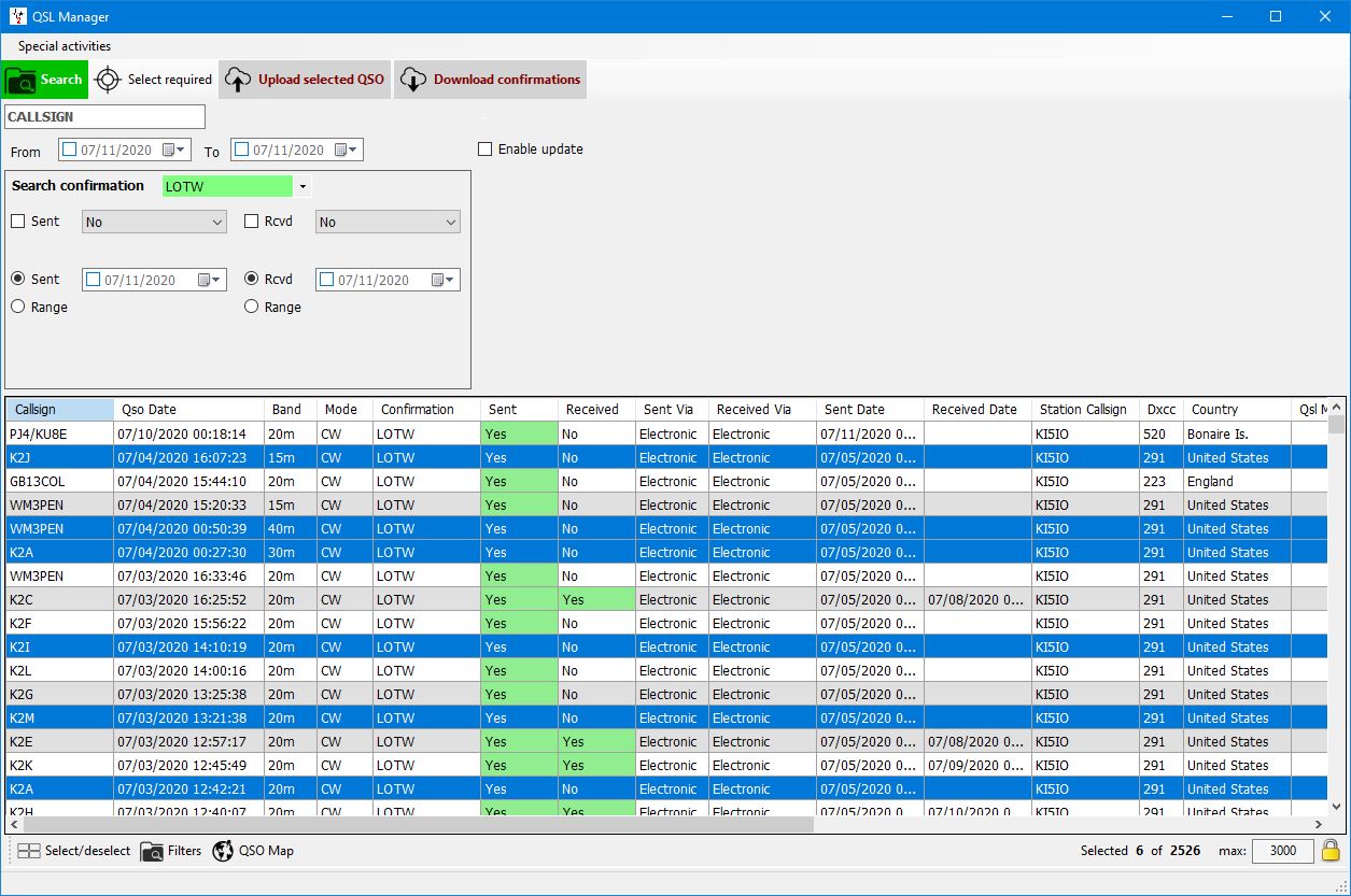

Regarding uploads (I'll focus on LOTW as that is what you have noted in your posts). You can easily pick/choose which Q's you want to upload to LOTW.
  • Open QSL Manager
  • Select LOTW in the Search Confirmation dropdown
  • Tap the green Search button (all of you Q's will then appear in the window)
You will likely see the recent (in this case 13-Colonies event) that you want to upload. Note that you can resize the QSL Manage window to show more/less Q's in the panel as you see necessary.
  • Click on each Q you want to upload. If they are not immediately adjacent to another another hold down the CTRL key on your keyboard while you are making your choices with your left mouse button.
  • Once you have completed this selection process tap the Upload Selected QSO button and complete the upload to LOTW.
  • Wait for the upload to complete.
Very easy and this type of selection process is what is common throughout the Windows O/S environment.
Screen clip below shows a few of the Q's I've selected for upload to LOTW. Don't be too critical as I've already uploaded mine, but wanted to show you the screen with the various Q's being selected as I noted above.
W3LI

Howdy again Nolan, Now that is the way I want to be able to do the LOTW Upload. I printed the procedure out and will follow it as I go along. Will keep the copy in the Log4 manual. I print everything to save.
TNX again.
Andy... W3LI

Nolan, just sent 52 q's out of 90 to LOTW with this procedure. Works well.
Andy...W3LI
