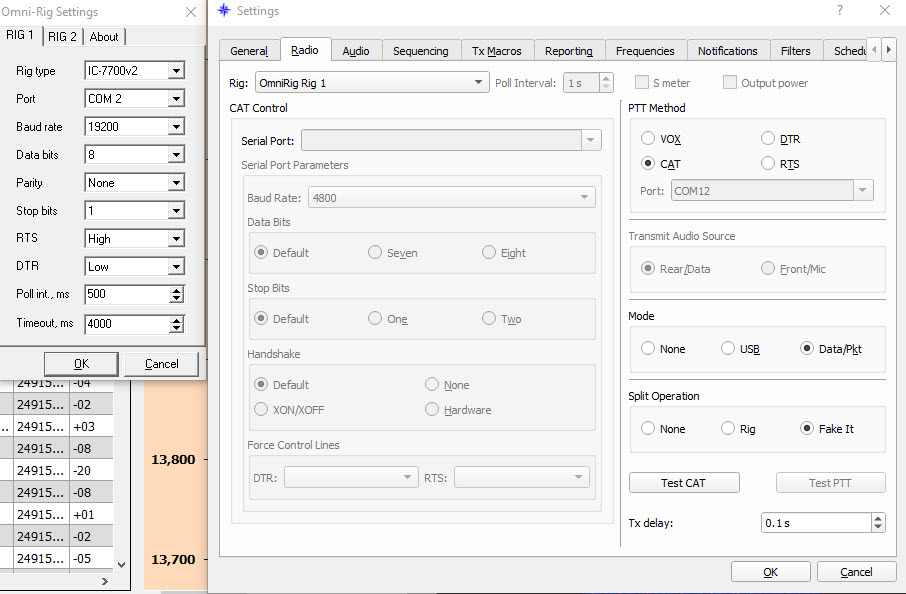

Here is my settings, se attachments.
The .ini file is not adjusted from original.
I can not find any ic-7700Data.ini file inn original install package...
I allso tryed modify the file ic-7700V2.ini with the data settings from ic-7850.ini with no luck... :D
7-19-2020 2-46-34 PM.jpg (123.38 KiB) Viewed 4782 times
So need more spesific solution please :)

Re: Icom Omnirig Issue
Use the 7700v2 data ini

Thx for getting me on the right path Terry :) .
Solution: Use the ic-7700V2-Data.ini located on the download page of omnirig, not included with the original setup with log4om. http://dxatlas.com/OmniRig/Files/RigIni.zip
