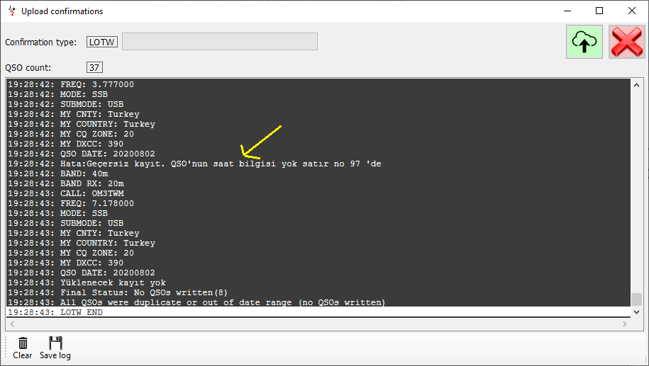

Hi I use 2.8.0.0 when i upload LOTW selected qso on QSL manager window give time error. "No has QSO time info on line 097xxxx. Also same problem QRZ.com loogbook manuel upload i cant see my qso time.
Need Help
LOTW upload error
LOTW upload error
- lotw-error.PNG (49.27 KiB) Viewed 4330 times

Check your QSO's you will find one that does not have a start or end time, the messages says it all

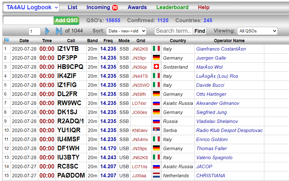

Look also no has time info qrz.com loogbook

Unlike the screen shot you posted I notice when looking up your call on QRZ that the logbook display shows the time on all QSO's you entered for last few days, here is a screen shot!

I think i find problem. Look to Time line and see big i TIME, time , is ok but TİME dont accept ,Turkish alphatic dont accept big i, must be I or i no İ how to fix it ?
Re: LOTW upload error
I export my last qso adif file and cut extra info look Write is TİME_ON its must be TIME or time
Not accept big TİME .
Can i change my computer keybord language or how to fix it

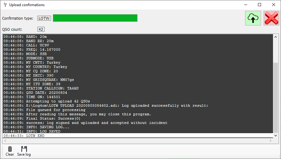

I change my keybord language and windos language and now upload correct time
