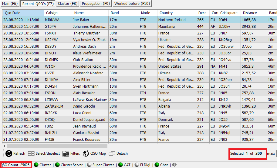

When opening "Recent QSO's" I can see the no of QSO's logged. In the window just beside it it is written Max 5000. What does that mean? limit is 5000. Can this limit be changed? If I change to 20000, this change is not stored. I would like to have all QSO's available-- eg 100000.
Re: Size of database
It indicates the maximum to be viewed, you can change the default value in settings/Program config to avoid having to keep resetting the field during use and restarts
By the way, you must know that the program will be slower if you have the complete contacts visible
in the Recent QSO Tab. Mine is set to 200 only but you can see the complete QSO Count in the lower
left corner ....
