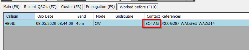

I Use a Log Programm on a Tablet for SOTA Activiations.
I import the generated ADIF Files from ths Log into LOG4OM.
The problem:
This Log Program generates this ADIF Tag when the station is NOT on a SOTA Ref:
<SOTA_REF:0>
Sample ADIF :
<adif_ver:5>3.0.5
<programid:15>Portable Logger
<programversion:3>1.0
<EOH>
<CALL:8>HB9III<QSO_DATE:8>20200508<TIME_ON:4>0844<MY_SOTA_REF:9>HB/AG-012<FREQ:8>7.059000<BAND:3>40m<OPERATOR:6>HB9DBM<STATION_CALLSIGN:8>HB9DBM/P<SOTA_REF:0><MODE:2>CW<NAME:5>Heinz<QTH:0><TX_PWR:2>10<RST_RCVD:3>599<RST_SENT:3>599<QSLMSG:30>Tnx for QSO. SOTA = HB/AG-012<EOR>
LOG4OM then generates an empty (invalid) SOTA Award Ref, see attached Picture.
I consider this a bug, could this be fixed pleae?
Many Thanks in advance
<SOTA_REF:0> ADIF Import
- SOTA-REF-0_Sample.png (7.87 KiB) Viewed 2306 times
Mark, HB9DBM
Mark, HB9DBM

Re: <SOTA_REF:0> ADIF Import
Hi there,
Sorry to insist, but there IS an SOTA Ref Tag, but it is emtpy:
See?
<SOTA_REF:0>
And that is exactly the problem:
If this Tag exists, why does LOG4OM import this Tag and assign an empty SOTA Ref ???
Simply do not import SOTA_Ref if it is empty, say :0
See?
<SOTA_REF:0>
Mark, HB9DBM
Mark, HB9DBM
So we note the field but don't have a reference to use
Get the program provider to fix his adif export routine!
