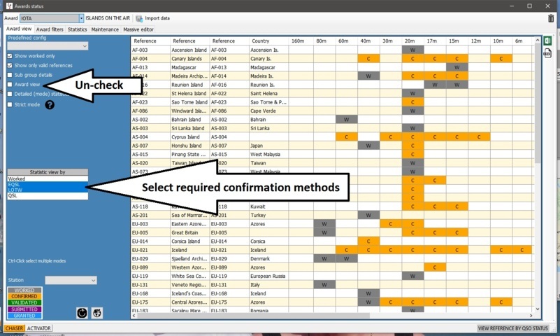

IOTA do not confirm for this award that's why you don't see it but you can ignore the IOTA rule by unchecking one of the check boxes and refreshing the grid.
Sorry I can't remember which check box and I am not near my pc

Hi Dave
Award Status must be down
You have to go to Utilities\Award Manager
You choose and edit IOTA Award.
In Confirmation panel you can change the rules
Save and exit
Hope this help
73 Phil
Posts: 11582
Re: IOTA Awards only showing worked not CFM'ed
The correct and easier method that I referred to

Got it, Thanks,
Dave
