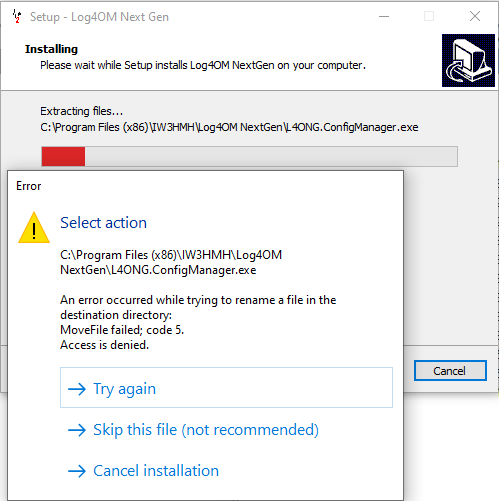

When I try and install 2.9.0 I get the following error message;
Log4OM install.PNG (20.88 KiB) Viewed 5118 times
If I check the file properties, (right click on the folder and files) and check security properties, then all combinations are ticked "Allow" for permissions. If I select "Skip this file", then everything else installs OK and I can run the programme.
I am not installing as an Administrator.
Any ideas?

Hi Peter,
Not helpful but I get a similar response when trying to upgrade from 2.8 to 2.9.
In my case the MoveFile failed error code is 2 and the explanation "The system cannot find the file specified"
OS is W10 64bit Home. I am installing as Administrator.
I have not tried to install using the skip file option but will give it a go.

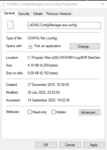

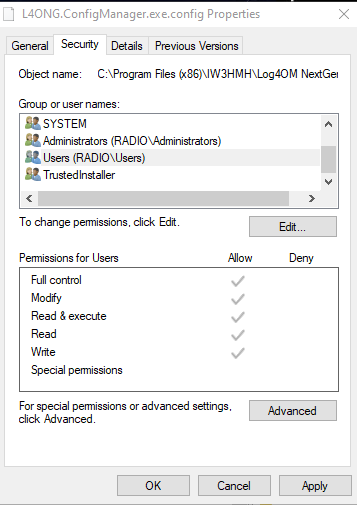

This is my file properties for L4ONG.ConfigManager.exe. I cannot see what is blocking it?
Log4OM General.PNG (18.55 KiB) Viewed 5084 times
Log4OM Security.PNG (19.52 KiB) Viewed 5084 times
73 Peter G3ZSS

Without Log4OM running try deleting the file then re-install 2.9
The file is only a tool we muse occasionally to update and change factors, not that important to you
