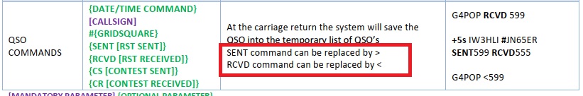

OK, I just can't get the comment field in there, everything else is working perfect.
after setting up day/time/freq/band/mode/grid, etc in LazyLog, my command line is:
[call] sent [report] recv [report] comment [comment]
The manual does not list comment as a field related to the final command line, maybe comment is the same for all LazyLog contacts, like Frequency? If so, I totally understand now!
Also, is there a way to do a "shortcut" for Sent and Recv like "S" and "R"?
One more thing... Do I need to pre-select my LOTW location prior to upload to LOTW? I failed to do that step, but my portable location grid was at least correct...

Re: no PC during POTA activation, now I need to manually enter... any tips?
KA1YBS wrote: 15 Sep 2020, 23:07
Page 38 last panel - Notice 'Comment' is not included, but we could add it, and sent = > received = <
Yes
Post by KA1YBS »
Thank You, Terry. I think I have the hang of it now with your pointers. I missed the ">" "<" symbols in the how to.
I'll do a new config for every LoTW location in the future and make sure the config is set up perfectly before doing the log.
