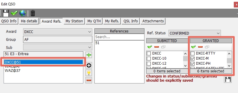

Can you please check the granted status for one of the QSOs you expect to show up in the DXCC list? Double click on the QSO, click on the "Award Refs." tab and click on the DXCC entry on the left side. In the right "GRANTED" box you should see all the granted award credits checked.
For example, I verified my 80m SSB QSO with E30GA and I have the following granted boxes checked: DXCC, DXCC-5B, DXCC-80, DXCC-CHAL, DXCC-M and DXCC-PH.

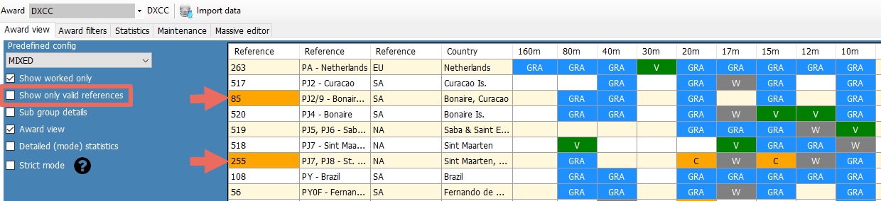

ad 2) "Predifined config" allows you to switch between different awards (band/modes), e.g. for DXCC, for example, DXCC Challenge, 5-Band DXCC, Single-Band DXCC, CW/MIXED/DIGITAL DXCC etc. The QSO above for example shows up as GRANTED in 5-Band DXCC, 80m DXCC, DXCC Challenge, MIXED DXCC and Phone DXCC.
ad 3) If you deselect "Show only valid references" you will be able to see all deleted entities as well. They are color coded and easy to detect. The idea behind the award feature is, that ALL awards tracked by Log4OM are handled the same way. To show deleted entities only would require special code for the DXCC award.
