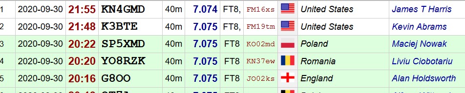

My uploads to LOTW are throwing back errors. I've notice the is a comma after the FT8 on QRZ as well. My LOTW certificate is in date also, not sure whats going on, have lost 15 QSO's so far and I've totally uninstalled Log4om and done a fresh setup from scratch and getting the same errors. Also my grid squares and ITU zone etc all match.
Capture 2.PNG (121.92 KiB) Viewed 3964 times

Your JT program (WSJT/JTDX etc) sends the mode to Log4OM, it looks like that is where the comma originated.
The comma will throw an exception with LOTW which QRZ is not so fussy about, I would take a look at your JT program to check whats happening but edit the Log4OM mode for that particular QSO to remove the comma then do a manual upload of the missing LOTW QSO's

Hi Terry, my whole log4om log had changed to "FT8," for some odd reason, I am in the middle of restoring it back as I have backup software AOMEI Backupper and restoring it back to a time everything worked, hopefully this solves me problem.

Ok so I restored my PC's partitions back to when it last worked and same thing happening, getting the "FT8," thing, I installed HRD software and no problems at all logging. I'm using JT Alert 2.16.13 and WSJT-X 2.2.2. Don't understand why its still doing it after recovering the PC, has me baffled. I'm still using Log4om 2.16 as I cant use the lastest one due to the freezing issue all the time.

So I downloaded the newest version of Log4om the problem went away, so I install the 2.16 version back in the problem came back, so defiantly a Log4om thing and not as suggested a JT thing. The newest version of Log4om works fine but I can't use it due to it freezing up after a while. I'll just use HRD for a while until theres a fix for the freezing issue within Log4om and eventually come back to it, until then I'm stuck with HRD.
