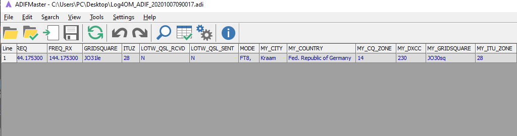

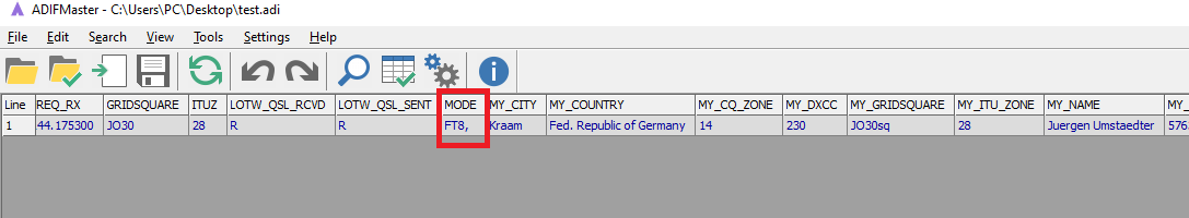

Hi Terry, have downloaded a portable 2.6.1.0 and setted it up for DL0AK (our club call). Logged FT8 QSO and it looks
fine in F7 Tab but when exporting i have the comma also here. But not in later versions of V2. Looks like this failure
is on V2.6.1.0 only.

Re: Corrupt mode in ADIF to LoTW
Looks like yo´re right. Have exported ADIF from latest A and also the comma is in.
Now i have to check all contacts with FT8 which was not uploaded to LotW. Needs a while.

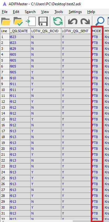

Have checked the LotW from the 2 tested contacts. My setup in 2.6.1.0 and latest A was to set all sent status
to NO but after closing tey where set to Requested. Maybe a corrupt upload to the LotW with the damned comma.
Found this only in my QSO´s from today and not in the older ones where i worked with JTDX instead of WSJT-X
today. I have also worked with installed Version for DF5WW and portable one for DL0AK and have this error only
in the portable versions. In the installed one all looks fine for the LotW send status "YES" ....
Another thing ist that i worked all 2m contacts with WSJT-X via JTalert but in the installed version no comma
in FT8 in the Mode field. It´s a mystery ....
