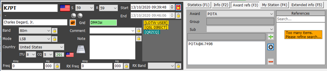

Just checked and that reference is not yet in the default list of references so what you should do having entered the call sign of the other station is as follows:
1. In te Award ref (F3) tab select the award (POTA)
2. Click on the Black cross (Add unlisted reference) and a small box will appear as below.
3. Enter the correct reference e.g K-7498 and click on the check mark icon - You will see the reference is now in the box as below
4. Save the QSO in the normal way
