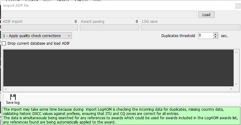

I have messed up with my 2 callsigns, trying to configure "the whole thing".
So I need to completely erase the log under Log4OM, and reimport an adif file.
The import menu screen now looks like the attached file.
The button that started the import has disappeared !
So I cannot import my adif file
Must I go through a whole reinstall ?

PS The button still does no show up when I have selected an adif file to import...

Check your screen resolution I think you set it to 125% if so reset it to 100%

What other problems? and did you realise the 'Import' button will only show after you have selected an ADIF to import?F6EXV wrote: 19 Oct 2020, 07:14 Hi

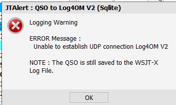

Using (or better said, trying to use) Log4OM + JTDX + JTAlert.
When completing a QSO with JTDX, I get a JTAlert error message. See attached.
BUT the QSO is indeed logged. So JTDX works OK with Log4OM. And JTAlert gets the callsigns OK from JTDX. So what is wrong ?

Thanks for answer(s).

F6EXV wrote: 19 Oct 2020, 15:52 Using (or better said, trying to use) Log4OM + JTDX + JTAlert.
In JTAlert there is a setting to change the time before a not logged message is generated change it to the highest value and the message will not happen.
The reason is that sometimes if Log4OM is doing another task the confirmation (Answer back) is not as fast as JTAlert would like!

The mystery continues... I only closed the whole set of programs, and reopened it. Now I no longer get the error message, but the QSO is logged twice ! What should I un tick, and where ??!!!

Do not use ADIF MONITOR and UDP
As it states in our usr guide if you use both you will cause duplicates !!
