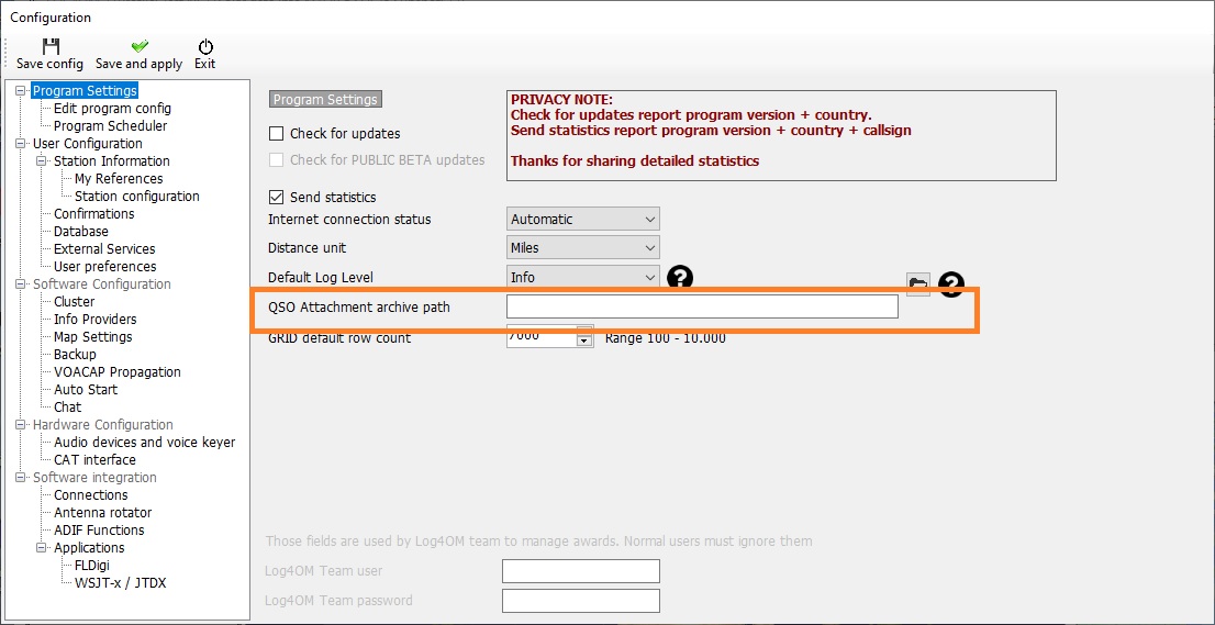

Already checked the Program Settings and the manual but I cannot see anything related to EQSL's path... Is there such an option somewhere ?
Re: EQSL display
Page 166 look at 'QSO Attachment archive path'

Thanks Terry! Did not know that option was related to this! Will try and let you know.

Thanks for help : after another complete EQSL download (and changed path), it worked !
