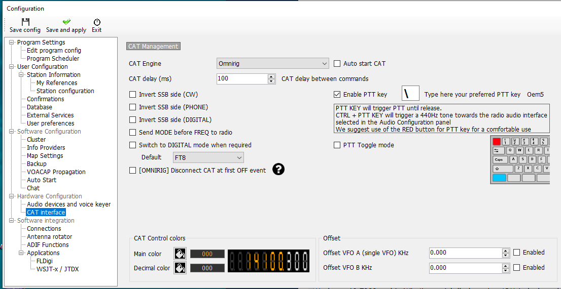

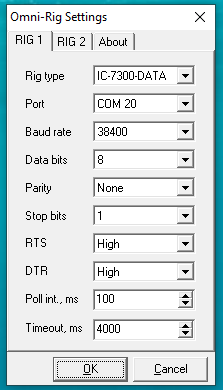

Re: CAT Bandwechsel aus Cluster Liste beendet CAT Connection
as you can see in the screenshot i use the IC-7300 DATA config for Omnirig - it changes all modes correct except of CW when I doubleclick on a cluster entry.
Thomas
Thomas
