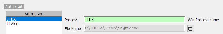

I am still struggling badly about this whole thing.
The initial setup rhat was wortking fine, had an auto-start of JTDX BUT with a jtdx.exe , not a jtdx.exe --rig-name=AAA. If I click on the little "open file" symbol and go to the directory where the jtdx.exe --rig-name=AAA is, it does not show.... while it is actually there.
Any suggestion as to how to deal with this problem ?

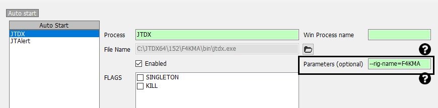

Re: 2 PROFILES
Solution was posted on another topic, which disappeared ...
Here it is :
Here it is :
- AUTOSTART.jpg (30.39 KiB) Viewed 1214 times
Thanks + 73
Paul F6EXV
