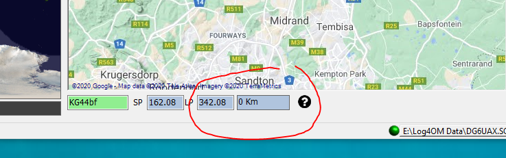

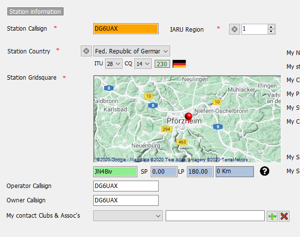

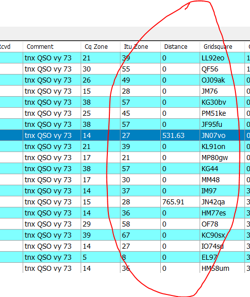

Hi folks,
Most times I don´t get a distance calculation in the main window and in my log, sometimes I have one.
On what is the distance calculation depending?
vy 73 Thomas DG6UAX
Re: No distance is logged
Distance is calculated on the distance between your grid locator and that of the other station

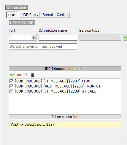

QSO´s are rerouted via Gridtracker, there I have activated the direct logging to Log4OM and I have an inbound rule in Log4OM as ADIF_MESSAGE.
Gridtracker is showing the distance correct in its call rooster, mabe it´s missing in the ADIF message from GT to Log4OM?
Maybe there is another combination between JTDX, Gridtracker and Log4OM, which works better.
73 Thomas

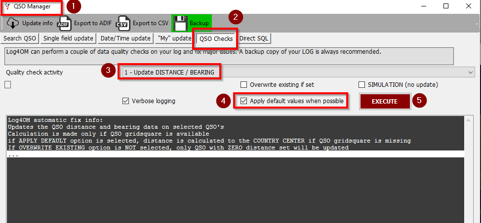

I can be fixed in the "QSO manager". Select all QSO's that don't have distance then go to the "QSO Checks" tab. You probably have to deselect SIMULATION

I tried to update the missing distance values via QSO manager - QSO check. But it also doesn´t update the QSO´s with zero value, although both grids are valid.
Maybe there could be a problem in the calculation method of the location-distance formula?
73 Thomas
