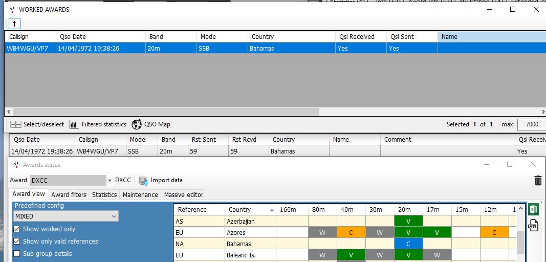

OK John,
I did as suggested and find that although the QSO appears in the DXCC Mixed it does not appear in DXCC phone, see below!
I will refer this to Lele
Re: Cannot Give Granted Status To Old QSO's
You are right Terry, it shows up in the Mixed listing but not the Phone matrix. Thanks for referring this one for a fix

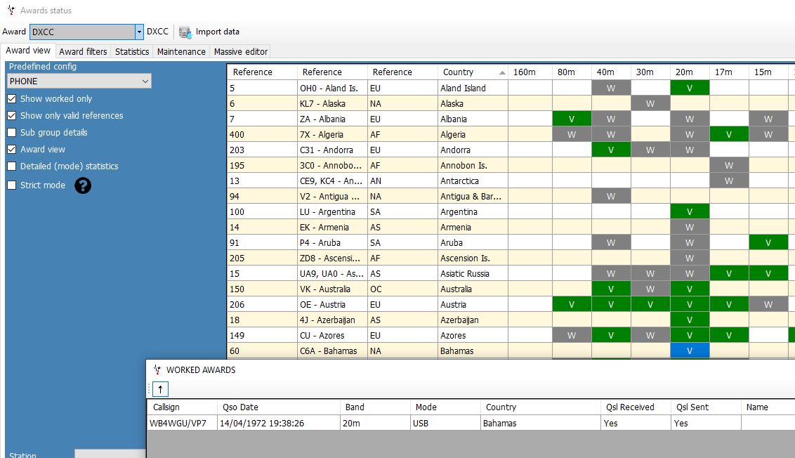

Here is my test QSO and as you can see its working fine
