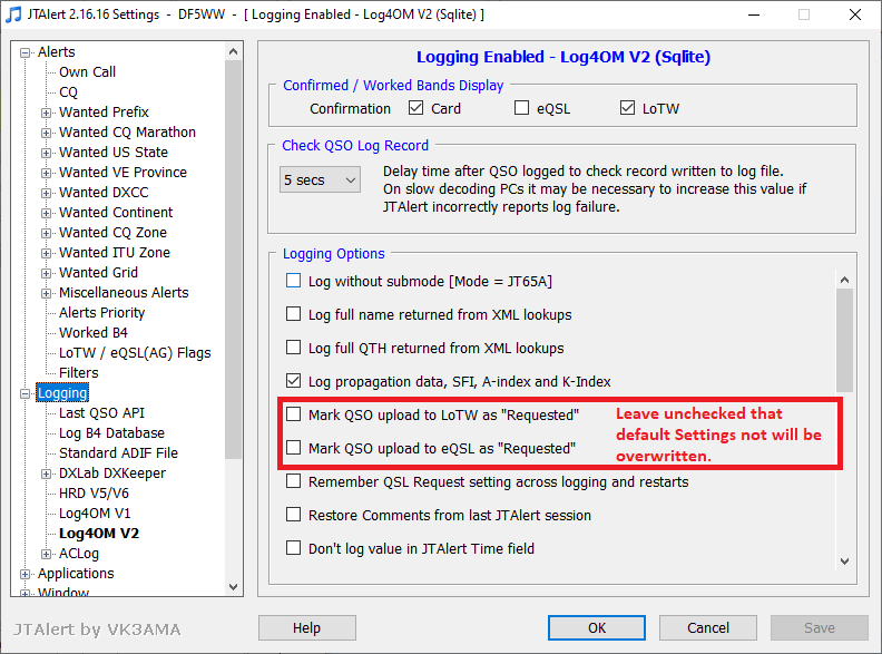

Did you mean that JTDX is sending the QSO directly to Log4OM without using JTalert ?
If so it´s not possible that JTDX changing the QSL status so JTDX send no wsl status
lines to Log4OM and/or JTalert.
In JTalert you can set that LotW will stored as REQUESTED (or not) and this will
overwrite the Log4OM defaults.

This is exactly what I missed, in JTAlert, Juergen !
Thank you for pointing that out to me !

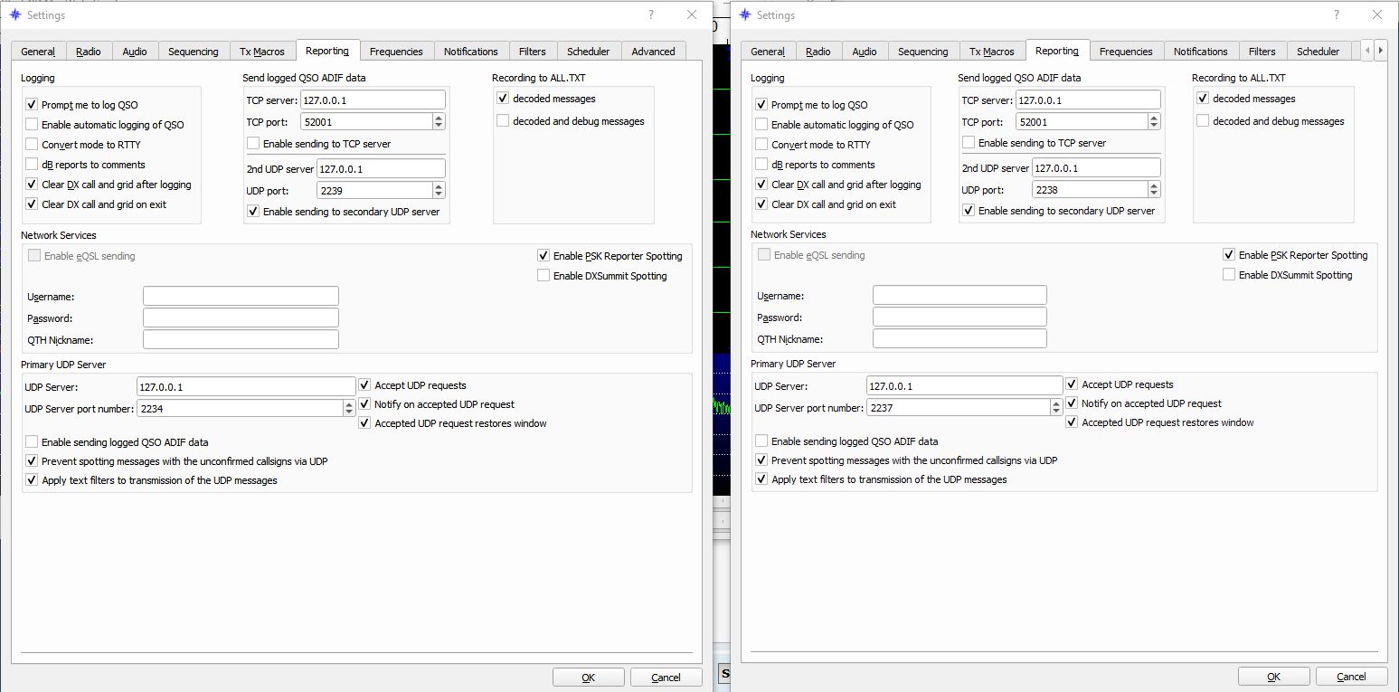

Well, I thought that was it... It is part of it !
Now the QSO is logged twice, some seconds apart, both with no longer changing the QSL options in L4OM.
The ONLY thing I changed was to tick these 2 off, so how come the QSOs are now logged twice ... ?

Seems you set it up incorrectly
Your either using JTalert to log and also UDP
or
You are using the ADIF monitor and UDP
Either will cause dupes

For a reason I am unable to explain, I prefer the logging to come from JTDX rather than JTAlert.
These UDP things are something I have NO understanding whatsoever. You are talking Javanese to me (not a criticism).
I want JTDX to log to Log4OM, and JTAlert to only alert me on new ones that I have programmed. I have two sessions running at the same time (you all read about it, right ?!), and as you can see on the attachment, my JTDX settings are absolutely identical (except the port numbers)
One session logs correctly (once), the other session logs twice.

So where must I look to correct this double logging, while both sessions are set up the same way, one works fine, not the other ??

You must have done something wrong on the UDP setup for the other call sign, or you set it up using duplicated UDP port numbers
