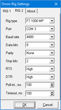

Post by F4HGU »
Here is the config:

what worries me in your omnirig settings :
For me DTR and RTS have to set "Low" not "High"
AND
You have the same value for the Polling interval and the Timeout Interval
For me the Timeout MUST be higher than the Polling ...
