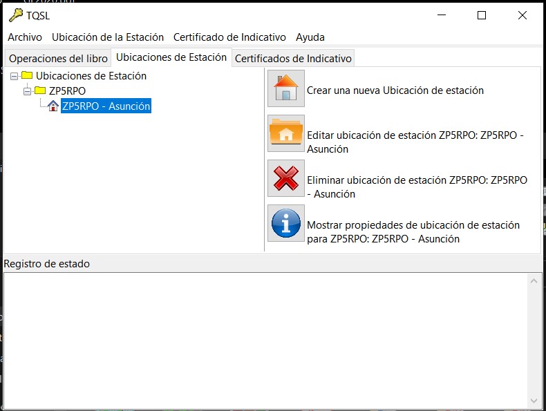

Re: Error uploading LOTW
Hi Juergen.
Thanks for answer, I think is OK my location:
Juergen.
I have changed the location to "Asunción" and the same error apears, in the version 2.9.0.0 the location "ZP5RPO - Asunción" worked fine.

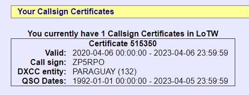

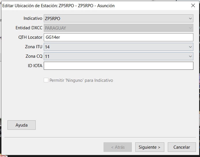

Do your zones in TQSL match the zones on your LOTW profile on the LOTW website?

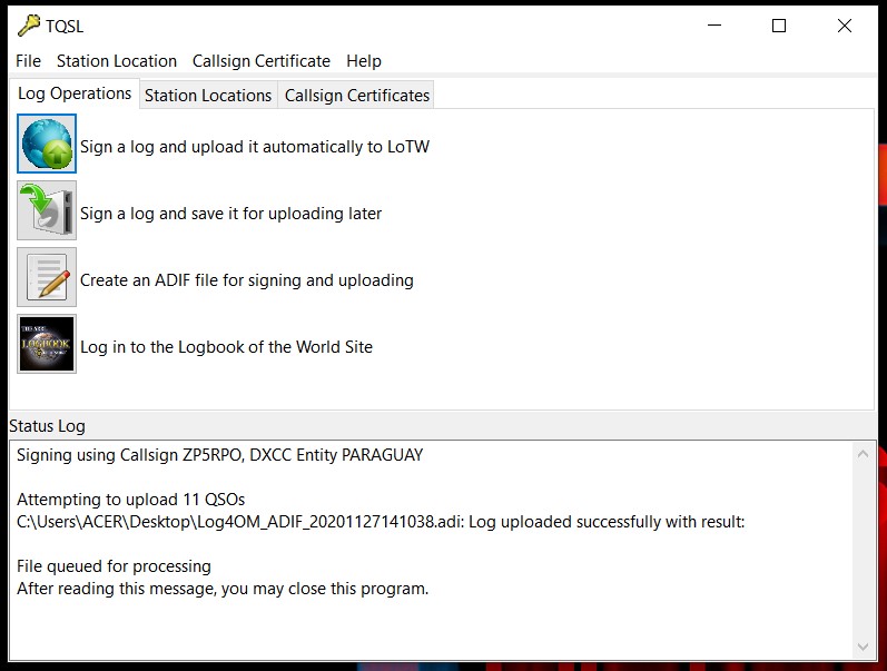

Hi Terry.
THis is the info I have found in the website of LOTW I can upload manually the adif of my new QSO's.
