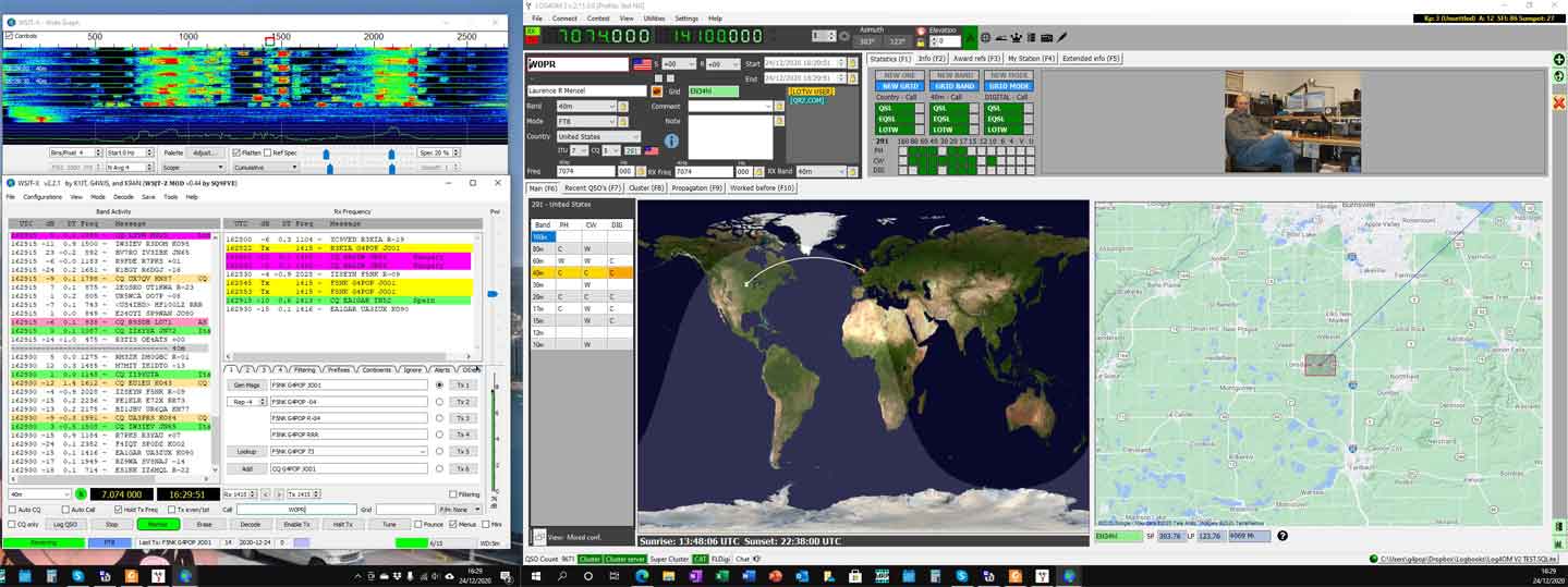

However I have just downloaded and reinstalled the latest version of WSJT and set up my own personal version of Log4OM 2.11.0.0 to integrate with it following the steps on pages 193 and 194 of our latest user guide exactly.
The result is that a call entered in WSJT is immediately displayed and looked up in the Log4OM UI, see screen grab below!
Clearly you have something set up incorrectly so please check again step by step using our latest user guide. (Help/User guide/English (Force update))
