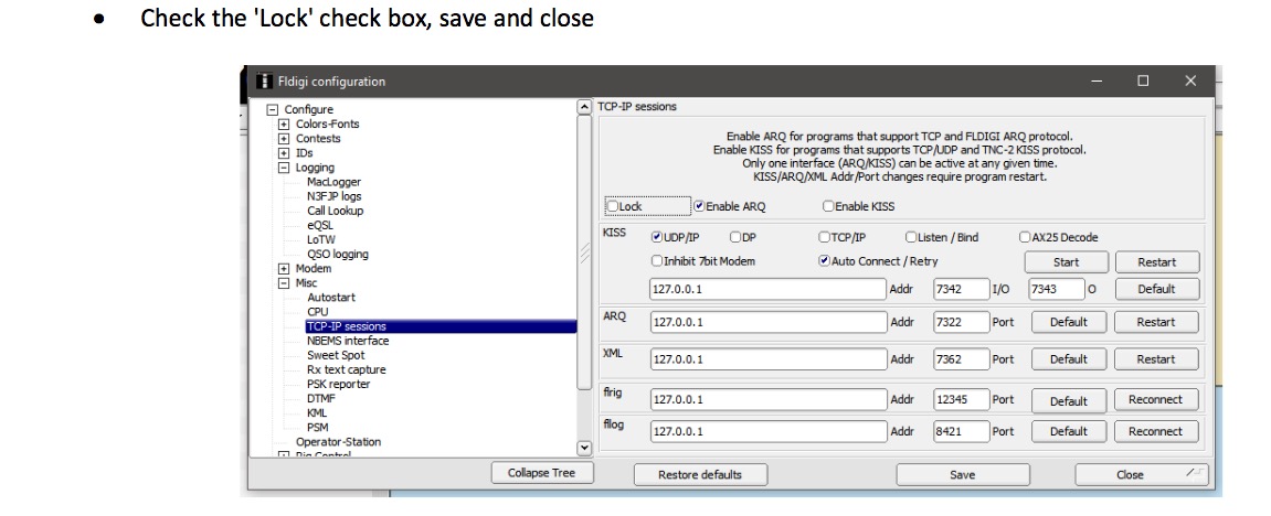

thank you very much to all the team for this new version, I haven't looked at the new features yet but I have a question about FLDigi
On the documentation (Page 203) it is written
"Check the 'Lock' check box ...."
but on the image we can see that the "Lock" box is not checked, hence my question
Is it a mistake ?
For this to work correctly this box must be checked or unchecked ?

In the image the lock box is not checked because if it is checked the other text is greyed out and not legible in a screen shot
YES you should check the lock box after adjusting any settings

Thank you but it would be worth detailing this procedure no ?
1) Uncheck
2) define your IP and Port addresses
3) Check
4) Save
