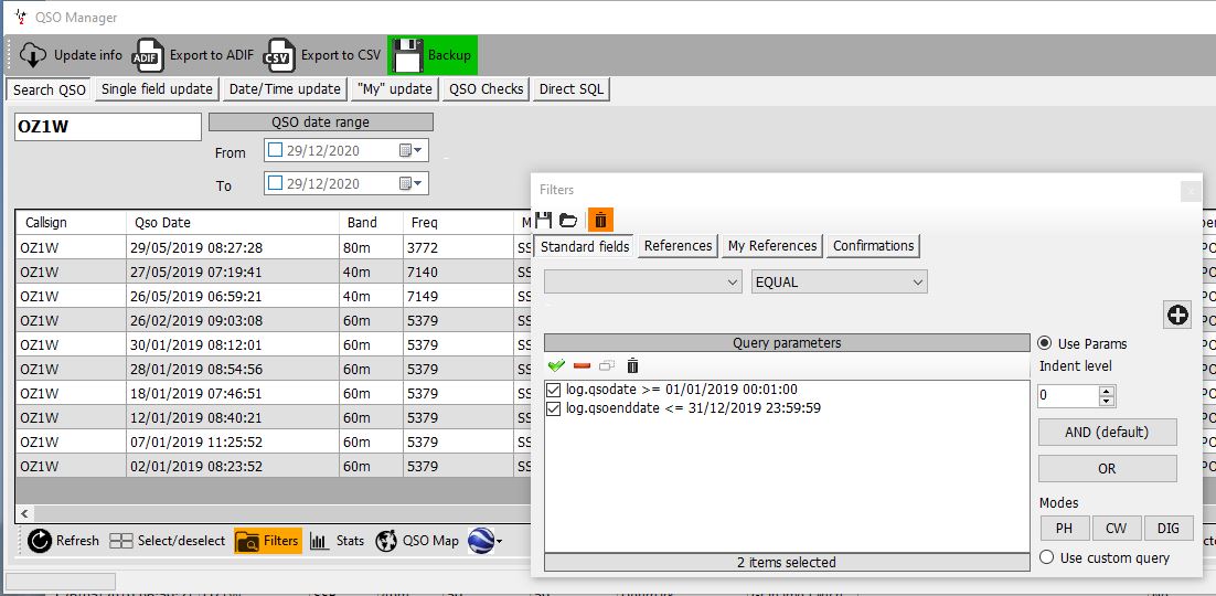

dk3dua wrote: 29 Dec 2020, 18:36 Is there a way to see if I worked a station in recent year already (in cluster spots, and after call entry) , and not only "at all" ?
I search for such a possibility for regular QSO's , no special "year long contest" mode.
Thomas
DK3DUA
The only way to do that is in the QSO Manager by creating a date range filter and then searching on the call sign as shown below

Yes I searched more for a cluster setup "station worked" ... "same year" , maybe this will be possible in future.
Just define your own "live cluster spot" query as SQL statement, that would be best.
