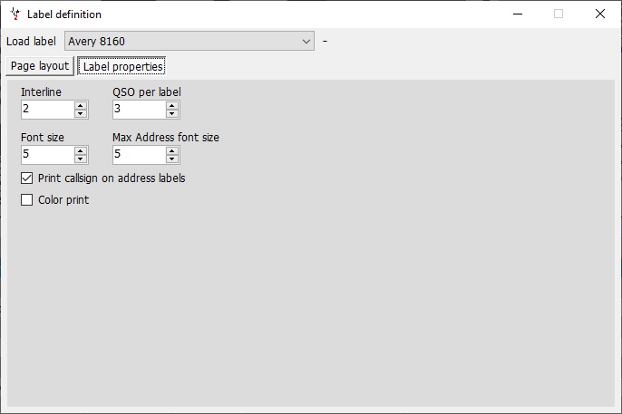

To print more than one QSO on a Label use the Lable Editor where you can set the number of QSO´s
that you like to print to one Label. For me i have set it to a max of 3 contacts.

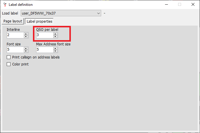

User guide page 107 second image, field marked as 'QSO per label' as shown below

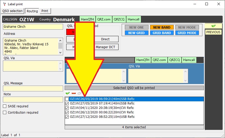

You have two opportunities in the print label routine to de-select QSO'S on the same band/mode with the same station.
First one is where you make the initial selection and the second by unchecking selected QSO'S when you verify the details
First HNY and a better one now we are out of the clutches of Brussells hi
