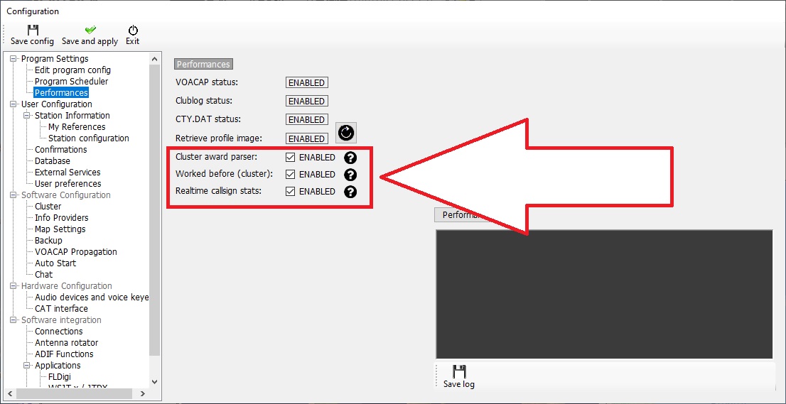

Try using HamQTH for lookup of call signs instead of QRZ
Also disable these check boxes then click save and apply - restart Log4OM
