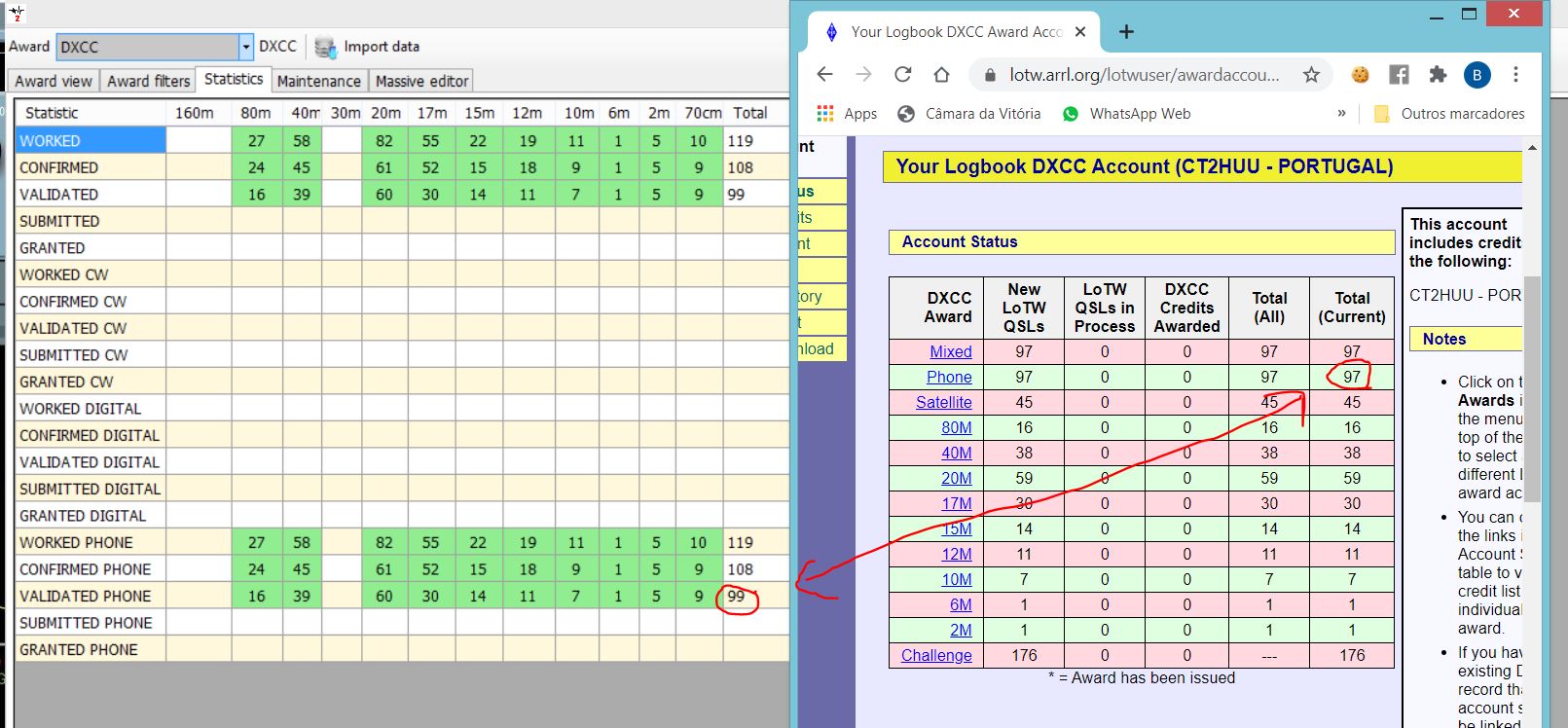

Hi
I have a similar problem.
Log4OM says that I have more countries validated that what LoTW says?! How is that possible? Tks

Hi Bruno!
Click in ARRL-LOTW-Awards "Select DXCC Award Account" (your Call) "View Award Credit Matrix"!
With 97 countries it's not so alot of work to check and compare with the log of LOG4OM.

Hi Bruno,
How are you tracking your confirmations? Are you using the QSL Manager in Log4OM to sync with LoTW? Have you used the massive editor in the DXCC Award Status?
DXCC only counts LoTW and QSL confirmations. What you are seeing under "Confirmed" will be the sum of both LoTW and QSL confirmations. "Validated" usually shows your LoTW confirmations. "Submitted" is used for QSL cards sent to ARRL or handed over to a field checker. When approved these contacts should be marked as granted. LoTW confirmations should be marked as granted after applying for one of the (many) DXCC awards.
You have two options now:
1) As recommended by Gerald, compare your confirmed countries in the ARRL LoTW Logbook with the ones validated in Log4OM. IN Log4OM go to the Awards status, select DXCC and unselect "Award view" in the left pane. In the "Statistic view by" box only select "LOTW" and click on the refresh button (at the bottom of the left pane). If you want to sort the list be Reference click on "Reference" on the top of the list. If you select "Prefix" in the ARRL LoTW app, you will have the same sorting. If you found the discrepancies, you can simply click on the corresponding DXCC/band slot in Log4OM and a windows will pop up showing your QSOs. By double-clicking a QSO the "Edit QSO" window will open and you can correct the QSL info -> "QSL info" tab -> Manage confirmation: LOTW: change the Rcvd from Yes to No and remove the check box from the date. Don't forget to save the changes! You have to click on the disk symbol in the "QSL Info" tab first, then on green hook to save the QSO. When done with all the corrections, in Award status click on the "Maintenance" tab and then the "RESCAN AWARD REFERENCES" button. Everything should be correct now.
2) The second option would be to wipe all award references under "Maintenance" in the DXCC Award status window and re-read all QSOs from LoTW. In QSL Manager select LoTW, click on "Download confirmations", select "Date range" and chose a QSO from date before your first QSO. Downloading all confirmed LoTW contacts again may take some time.
Honestly, I have been using Log4OM for many years and 4 different callsigns. All 4 logs are 100% in-sync with LoTW (modes, bands) regarding New LoTW QSLs and Total (Current) QSOs.
Please keep in mind that Log4OM2 for now does not take deleted entities into account in the numbers shown in the "Statistics" window, but this is on the list. Nevertheless, if you unselect "Show only valid references" also deleted entities will be shown (and marked in the Reference ID column).
Hope this helps.
Claus, OE6CLD
