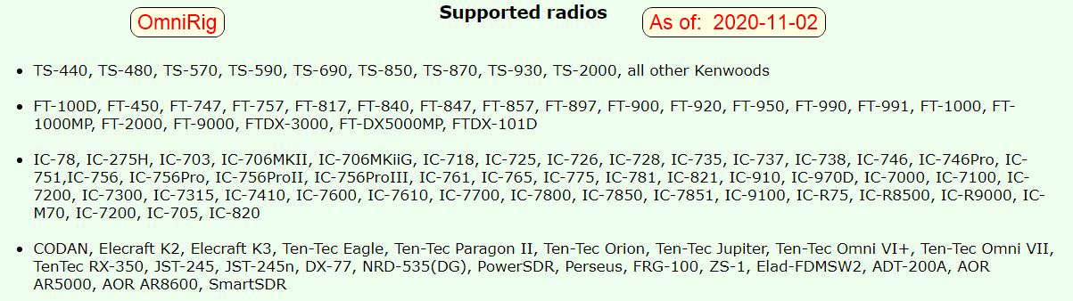

I use omnirig. My Yaesu FTDX101D operates using the 991 on the omnirig drop down menu. The FTDX10 does not. Any other assistance would be appreciated. Many thanks, Dan K2DJL 73s
Re: CAT Control the new Yaesu FTDX10
Dan,K2DJL wrote: 12 Feb 2021, 01:12 I use omnirig. My Yaesu FTDX101D operates using the 991 on the omnirig drop down menu. The FTDX10 does not. Any other assistance would be appreciated. Many thanks, Dan K2DJL 73s
The most recent OmniRig 'rig.ini' zip file does have an ini for your FTDX101D. You could update the rig.ini file on your installation and give that a try and then see if it might work for the newer FTDX10 rig.
The developer does not yet list the FTDX10 as supported, but often another one will come close to working.
Here is a link to the DX Atlas downloads page. Scroll down to OmniRig and then download the rig.ini zip file. It was updated: 2020-11-02
You could also send an e-mail to the developer of OmniRig and ask when/if he might have an ini file constructed for the FTDX10 rig.
http://www.dxatlas.com/Download.asp
- OmniRig-supported-radios-11022020.JPG (103.01 KiB) Viewed 14962 times

I updated OR in with the download you've noted, however, the drop down box in OR did not update on LO4OM. When I switched to Hamlib, the FTDX10 works when the Yaesu 450 is selected. Dan K2DJL 73s

I was able to properly set up my FTDX10 on omnirig utilizing the drop down for the Yaesu 991. I apparently had the com port number wrong. Thanks to everyone for your input and information. All the best 73s Dan K2DJL.
