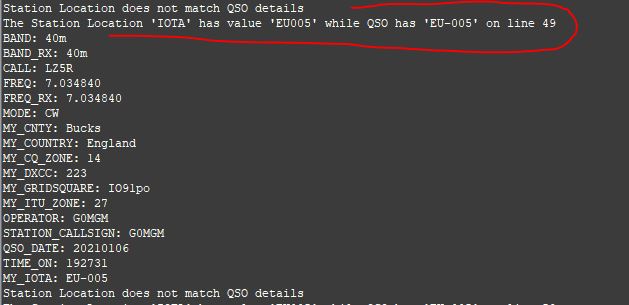

Not sure what is going on but Im having issues uploading QSO to LOTW.
Once the QSOs are selected and Upload to LOTW clicked I get the process window attached for every QSO I try to upload, so none are being recognised in LOTW.
Im not sure why the highlighted portion has changed or where I can change this.
Any help as always appreciated.
Rob G0MGM

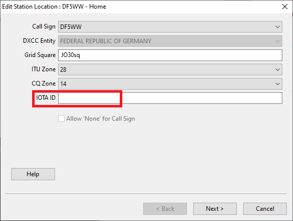

Looks that you have set your IOTA ID in the station location of TQSL to EU005 instead
of EU-005. Try to change to the correct one.

Hi
Is that on the TQSL app?
Rob

Thank you very much, that worked.. not sure why that changed but it is all good not.
