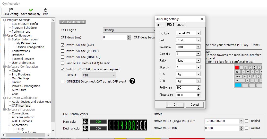

This is working fine for me, have you updated the K3 firmware?
I am also using Win 10 pro 64 bit with latest public Log4om 2.11 and Omnirig 1.19
This is my Omnirig set up if it helps you, would be interested to hear from other Elecraft users.

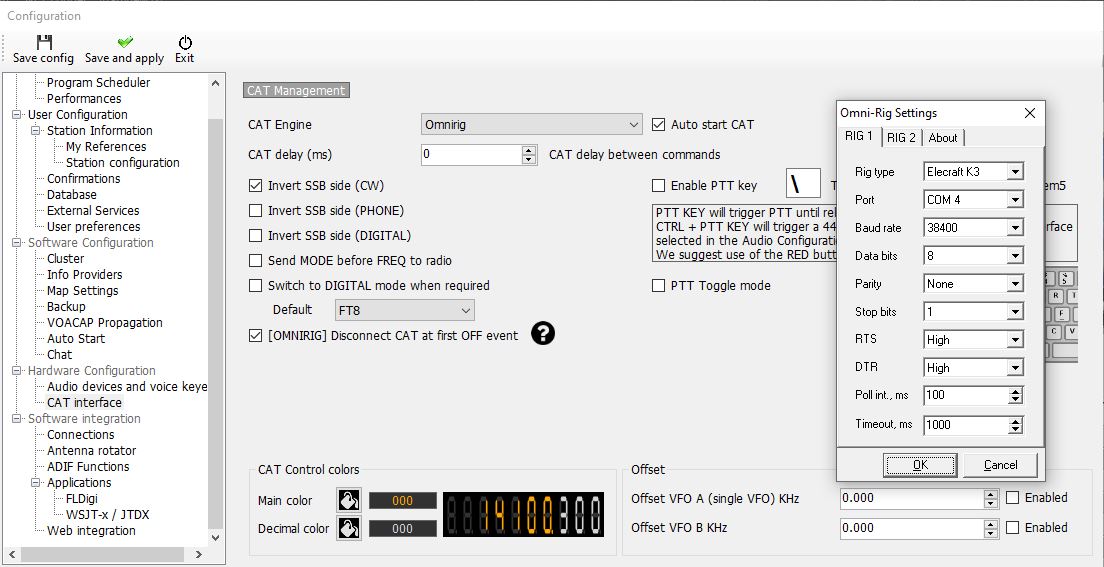

Re: V2.11.0.0 double-click on Cluster (F8) not working
yes I am on the latest K3 firmware 5.67. My configuration looks very similar as yours:

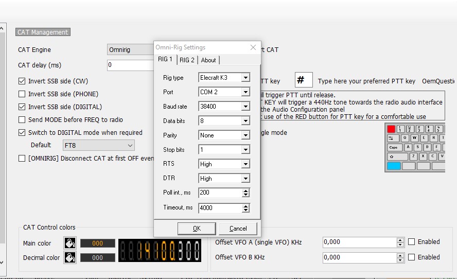

Olaf,
I use a K3, OmniRig for my CAT interface. My current configuration is noted below. Not terribly different from yours.
I can double-click on any spot from the Cluster (F8) tab and the proper band changes are made and will also change to new frequency in the same band.
I use a USB cable from my laptop (with Log4OM V2) to the KIO3B input to my K3. I did update/upgrade to the newer KIO3B board in my K3.
I do not have a sub-receiver in my K3.
Seeing as how I seldom run digital as I'm ~99% CW ... I do not run Log4OM V2 and OmniRig in Admin mode as (for my use) it is not necessary.
My testing today was simply my laptop connected to my K3 via USB cable and I only had Log4OM V2 running on my laptop.
I'm able to have the double-click function FB from both the Cluster (F8) tab and a separate BandMap window.
