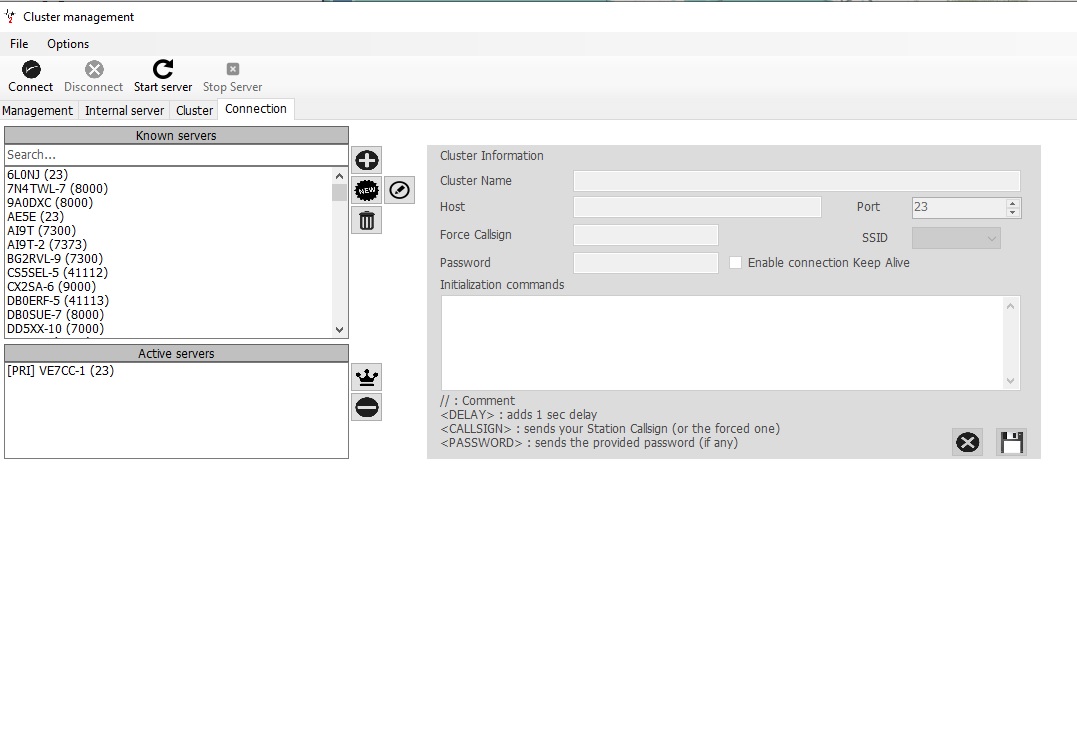

Can you provide a screen shot of the "Connection" Tab like I posted above from my installation?
Re: Cluster Spot Filtering
Posted: 19 Feb 2021, 21:53
by VA7RPE
Here you go:
Log4om Cluster Connection.jpg (95.84 KiB) Viewed 3032 times

Rob,
Couple more things:
Make sure the ve7cc-1 login script is blank. See my script for ve7cc-1 below. If you are sending "sh/dx100" it will bring down 'all' dx.
You also have to wait for a spell of time once you login so that the initial cluster feed will clear and your personal filters to show.
You can also try to send ... "sh/mydx100" ... from the "Send Command" line on the Cluster Management / Management tab and see what results you get.

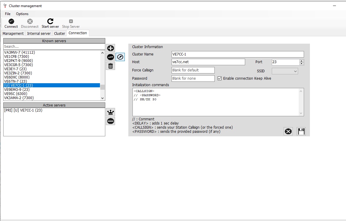

Posted: 23 Feb 2021, 16:56
by VA7RPE
Screenshot as requested:
Log4OM VE7CC Cluster Settings.jpg (117.05 KiB) Viewed 2958 times
Here are my answers to your questions:
Did you do all your filter selection settings from within CC User while logged into the ve7cc cluster?
>Yes
Are you using the same login ID from CC User and Log4OM V2 or do you have 'many multiple' logins and thus using the SSID extension? Typically all logins under a value of -15 get all the same filtering. Values of -16 and up are individually discreet.
>Same login ID
